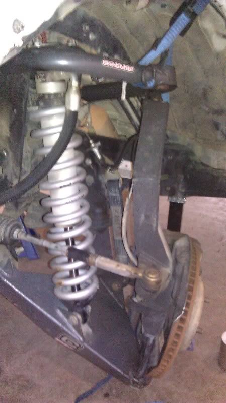

    sleeve around the lower uniball came completely off the adapter

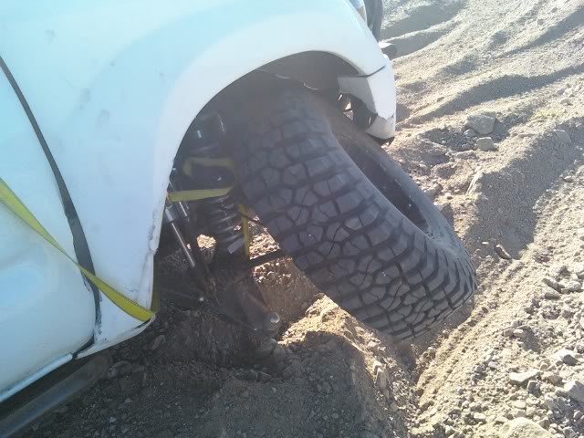

    another pic

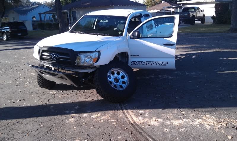

    nice! this happen to him a couple weeks ago...
    this guy lives around the corner from me i see him all the time nice truck
    i hope everything's alright

    Yeah, when I got on my computer I noticed that it's super tight. Definitely an interesting design, that puts a lot of shear stress on that bolt where the bypass mounts tho, wonder how it held up:cool:

    He probably installed the adapter upside down. Easy mistake the make. :eek:
    If it's installed incorrectly, the weight of the vehicle is supported by a C-clip instead of a welded steel ring.

    or they snapped that lower bolt

    That's probably why the new kits come with a Grade 10 bolts now for that adapter now:cool:

    That's why I use 3/4" hardware

    I dont get it though because tc uses the standard 5/8th hardware and i havent heard of any failures, some bent but never snapped.

    Maybe improperly strapped and when the lower uni-ball maxes out all the the force is applied to the bottom misalignment spacer since the upper doesn't hit the edge of the cup because they use that special bolt. I hope that makes sense my brain is still asleep.

    Oh that makes sense as with tc theres less shock load to the bolt as it hits the lower misalignment and the head of the allen bolt at the same time.
