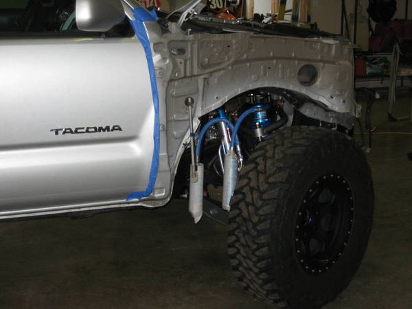

    you can adjust the angle of that fitting also,just need to back off the nitogen and then use a backup wrench on the fitting goin into the shock,loosen the flare nut and adjust were you need it.then recharge, that seemed to help me with getting at them with a spanner wrench and routing for the reseviors,ill try to find a pic

    [​IMG] [​IMG] here ya go.....
