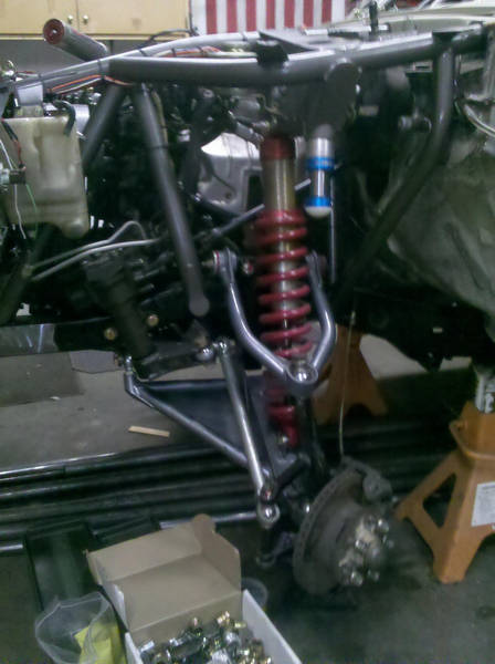

    A plate on the bolt for the upper uniball

    Always in line with the spindle bolt and make sure you have your kit aligned first before setting it to bump.

    Anyone have pics of this stuff??

    keep in mind the strike pad hasnt been welded to the bolt yet

    Hookay, so
    Align kit.. put strike pad ontop of UCA bolt.. then mount the bump.. and always in line with the spindle bolt? got it

    Just have to make sure the bump is mounted right with the travel of the suspension or it will scrub on the strike pad and could rip the bump out

    so if you hit something big and mess up your alignment, you can potentially fuck up your truck if the bump stop misses the strike pad.
    At that point, the owner should have his alignment tack welded, correct?

    The alignment should be off the heims on the upper not on the cams on the lower at this point

    that's something i'm eventually going to do. solid mount the lowers, convert my upper arms to heims and then bump off the spindle bolt

    how will he bump of the spindle with no bolt head there with camburgs new 1.250 uniballs :?

    I wasnt aware they had no bolt head..!

    Get a set of miss-alinements and a new grade 8 bolt problem solved

    Put a normal misalignment on it
    Fixed :)

    Take the cams out and use weld washers to eliminate the cans.
