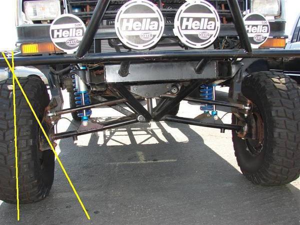

    it actually cycles ok, but it cant really steer ha think about the King pin inclination! its like 3" inside the tire!

    ahh okay i see, whats the best angle to have? "king pin inclination"

    Its not really a set angle to achieve, depends on the wheel offset, tire size. Kind of the rule of thumb for off road is about 1" inside the center of the tire

    caged, camburg long travel, 50t leafpack (soon to be installed) light rack over cab, 5pt harnesses etc
    oh wait are you talking about where the outside of the steering mounts? how its pretty far away from the tire?
    or are you talking about the length of the uppers and lowers?
    sorry still learning alot of the more technical stuff
  12. Mar 21, 2012 at 9:21 AM
    Supermoto
    Supermoto Well-Known Member
    Feb 7, 2012
    #72373
    2,589
    Landon
    Fallbrook
    this virtual line, and that 1" i am talking about is "D" on that diagram

    I tell people image a line in between the upper and lower pivot point on the spindle then they still don't get it lol

    Mean like that? haha
