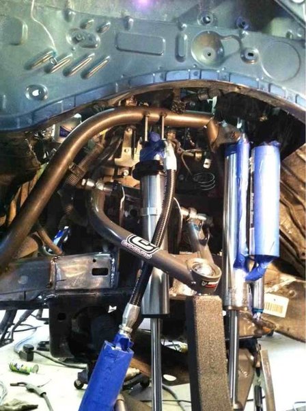

    so jelly !^

    I like how its bolt on... But then you went beyond it and added 12 inch coilovers and bypasses. :D I know Captain obvious over here

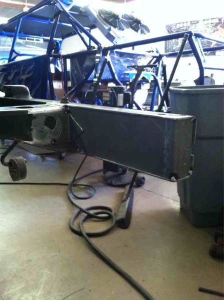

    Hey RJ Im not too sure about uniballs but I know your not supposed to hook a ground through a bearing. I see you have the ground clamp on the alignment bolt so it probably jumps through the frame but if it takes a path through the uniball you wouldnt want to melt the teflon inside

    they are actually 10s
