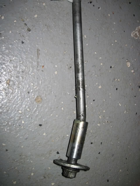

    Do both! The coil bucket gussets have the added benefit of double-sheering your UCA mounts. Crap like this gets old quick:

    is that ur UCA bolt or your shifter lol?
