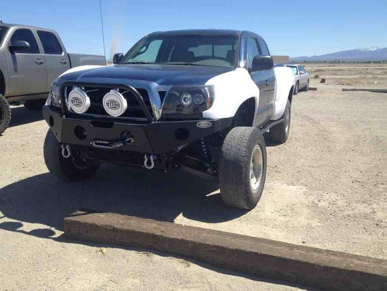

    Here is how I replaced my LSPV
    The red #1 fittings are the lines going to the rear brakes from the master cylinder
    The yellow #2 fitting is the return line from the stock proportioning valve, excess pressure is diverted to the front brakes
    The green #3 fitting is the line going to the left front brake from the master cylinder
    The blue #4 fitting is from the junction of the rear brake return and the incoming front brake line from the master cylinder, and goes to the fitting just under the inner a-arm pivot to the left front brake
    Now your going to completely remove lines #4 and #2 and discard. Your going to take line #3 and connect to the fitting under the arm that line #4 used to connect to
    The rear is very easy. As said your are discarding line #2. You then take the stock LSPV and discard it. That leaves line #1 to connect directly to the rear brake line coming off the axle
    Then under the hood your going to connect the Wilwood proportioning valve in between the master cylinder and other end of line #1. I did have to remove the two bolts that hold the master cylinder and slide it forward and completely close the proportioning valve to get the valve to be able to clear when you spin it around to tighten on to the master cylinder
    The brake lines did have to be bent around quite a bit but if you use your hands and make sure you dont make all of the bend in one spot it will be fine. Just make a slight bend, slide down the line a little and bend more, slide, bend etc. Thats all you have to do and all of the parts needed are right here
