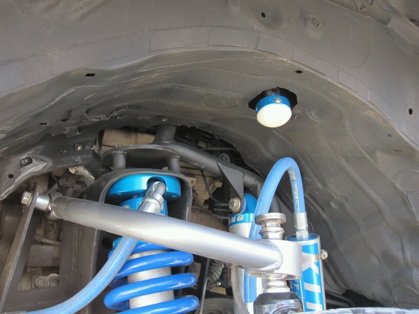

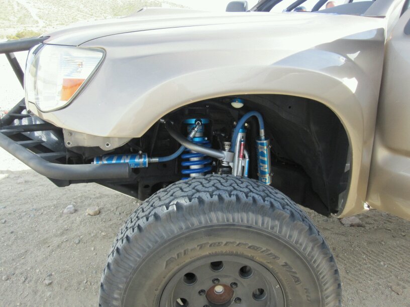

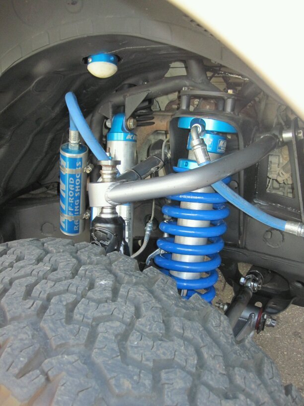

    2" or 2.5" if you're going off the the lower and 4" if you're going off the spindle bolt. Cant do it off the stock spindle and you need a engine cage
    example on a first gen

    I have 2x2" bumps in the front cuz im bumping off the LCA, but gonna take out the spacer and go 2x4" cuz im bumping off the UCA soon.

    07 TRD Offroad

    All you have to do is fully box and strengthen the stock spindle and you should be able to bump off the UCA bolt. You just need to weld a strike plate on top of the bolt.
    I dont have aftermarket spindles but Sick Nick is going to fully box and strengthen my stock 4x4 spindles to bump off the UCA bolt.

    less bump travel, more effective leveraging position farther away from the pivot, and i can use a 4" bump stroke without having half of my suspension travel in bump. Also less scrubbing on the bump stop.
    Overall, it is stronger and more effective.
