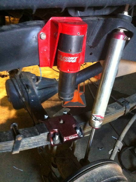

    Was looking thru your pics and is that a custom strike plate for the LR bumps or do they sell that? Also, what's your review on the WE rears, 2.5's right?

    I think that is the ubolt flip kit, not sure tho, looks beefier

    that aint allpros flip kit

    Yes, the Strike plate is custom made to be able to run a U-Bolt flip along with the LR Bumps without sacrificing uptravel. The shocks are just the WE 2.0s, they do alright, heat up fast tho, will be upgraded soon.
    It started as a standard U-Bolt flip, then had bolts made at local industrial shop as the U-Bolts I had corroded/rusted. See above for the rest.
    No :cool:

    Ya, the LR strike plate design sucks! That looks good man!

    It's not the strike plate design that's bad (my strike pad is designed based off of the Tundra LR Strike plate). It's that you can't use it with the U-Bolt flip plate without raising the plate up an inch over the threads so this eliminates that need. :cool:

    I don't see that kit being very strong. I mean, it's not even welded! Just tacked. :rolleyes: :rofl:
