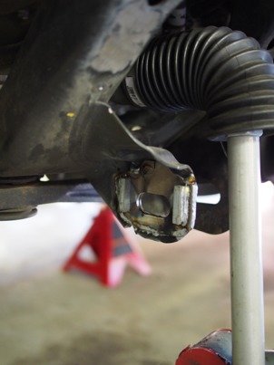

    From Tim at DMZ:

    do you have to gring off the old cam tabs?

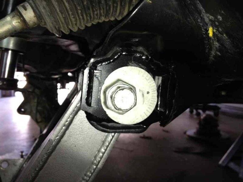

    u have to remove the old cam tabs and weld the TC ones on. They are just bigger and beefier. I didnt bother with that and got my cams tacked, even though every single one of my cam tabs are bent almost flush haha. Im getting weld washers installed within the next week or so.

    The cam tabs add more material around the frame. You only weld the tabs not the bolt. That way you can remove or replace the bolt if necessary.
    Here is a pic of my tabs. It's all I got for reference.

    I highly recommend the cam tab gussets..my alignment guy was doing the alignment and one of the shitty stock ones bent and just fell off. No point in doing the alignment if they aren't going to stay in place. I had the SD truck shop put mine on.
