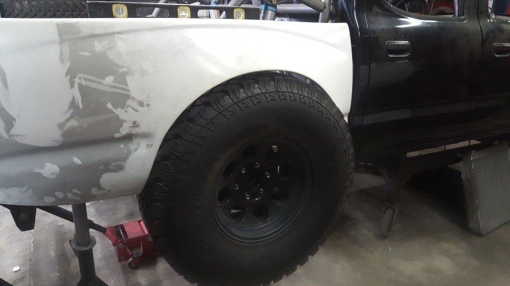

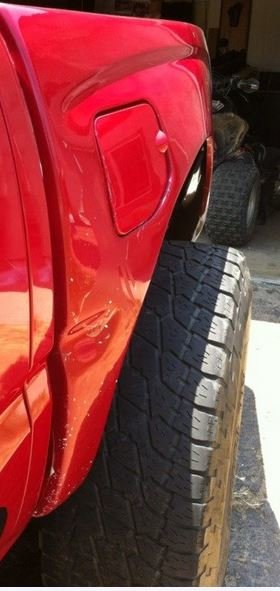

    They are Glassworks Unlimited/Advance Fiberglass Concepts 8" Bedsides. The 4.5" were too small of an opening for a 35 w/LT so I made the jump to taller and wider.
    Here are my old fenders:
    My current fender are straight up out of the mold, no modification needed. The tire has kissed the bottom lip a few times but nothing some minor tweaks cant fix.
    ***you lose the fuel door with these so if you take the leap you will have to fill your tank from inside the wheel well or reroute the filler neck
  10. May 27, 2020 at 5:50 PM

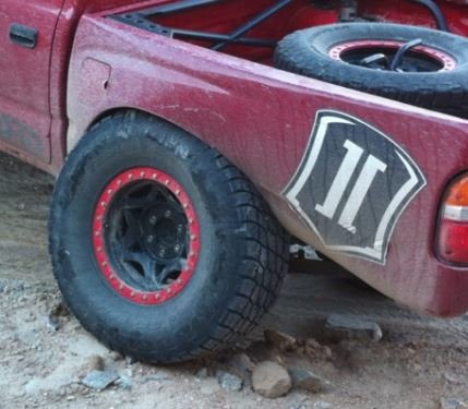

    damn I was hoping you weren’t going to say that hahaha. I bumped up to 35s and have been in the fence about cutting mine. The radius is just tight enough at bump it smashes the rear portion pretty bad. Gel coated already cracked there so might just break out the diamond cut off wheel.
    If I totally flub it, I guess new genders are in order. What width axle you on?
    Icon_Adrian[QUOTED] likes this.

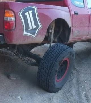

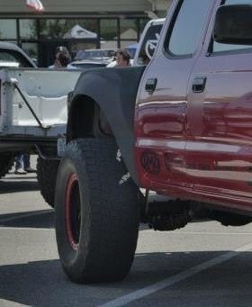

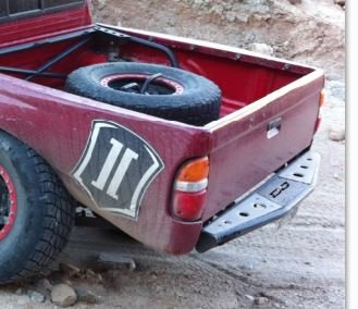

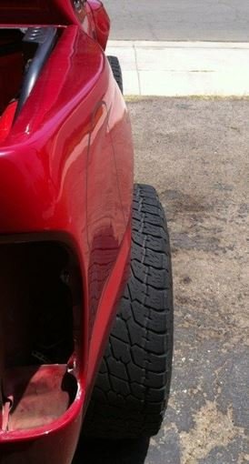

    They fit when you dry cycle straight bump but if the other side drops out while you stuff one side it hits really bad.
    This happens...
    when the other side does this...
    I needed wider glass anyway. 06 Tundra axle with 4.5" BS makes for a wide truck.
    Still sicks out a little but I'm happy with the look now.

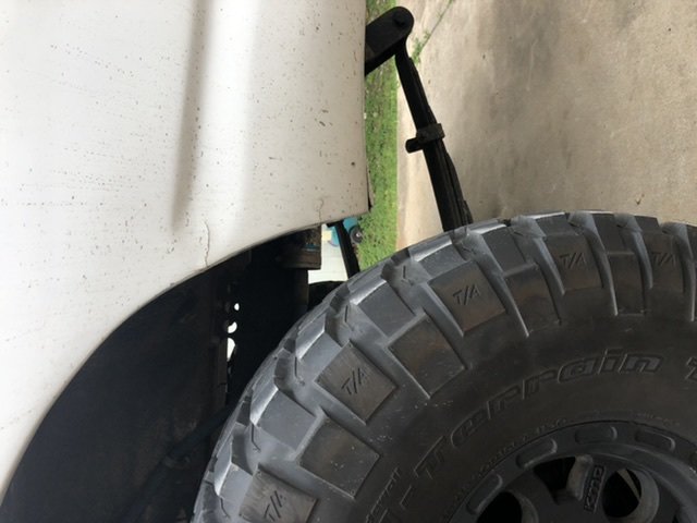

    love it. Yeah my 33s tucked perfectly to full bump even drooping one side 15”. The 35s are just big enough they catch the tighter radius of the rear before my bumps.
    1E70524B-2912-4CA7-9C60-054FE1E8E433.jpg FE34BD26-7110-400A-B91C-68AB0FE7A2F0.jpg
    You can see where I smacked it and cracked the gel coat. I’ll probably just open up the radius way more and get it to tuck.
    I’m on a Currie 9” with 60.5 to the hubs. Forget my wheel offset but I def stick out a lot.

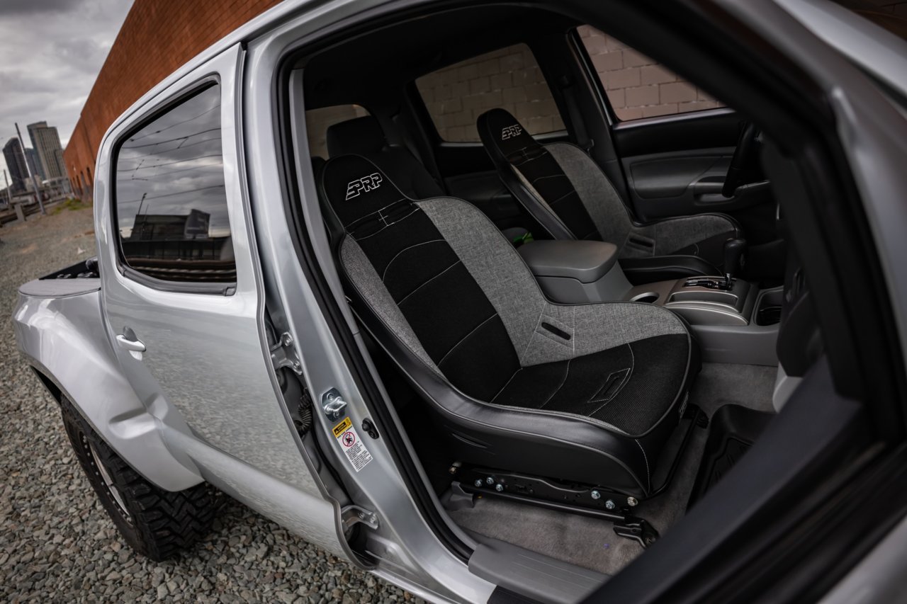

    What mounts are you running with your PRP's? I just ordered one for my drivers side to verify i like it before i go full kool aid. just haven't seen a ton of aftermarket seat sliders and mount options for our trucks. Truck looks sick btw!

    I have the solo mounts too and love them!
