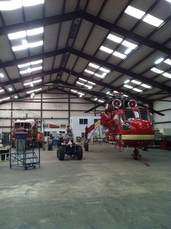

    My work in the winter months usually

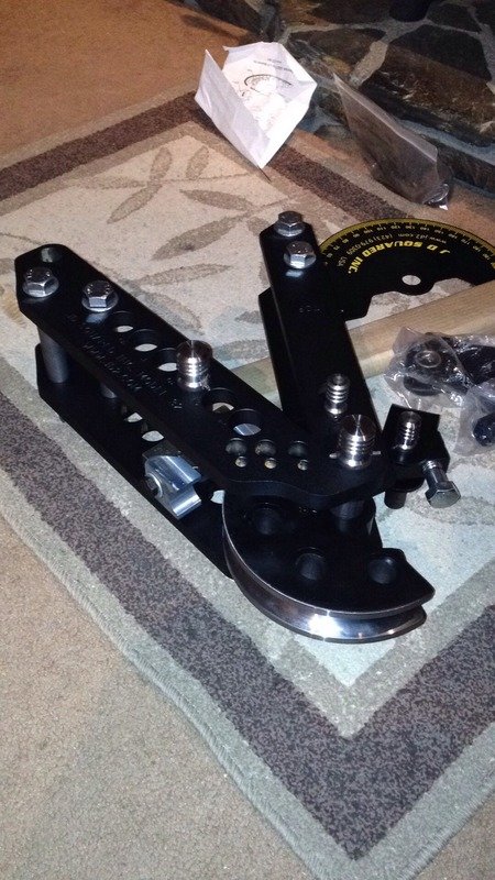

    Got my bender today, gotta make a mount and put my HF ram on then it's time for radiator support, engine cage, secondary shock hoops

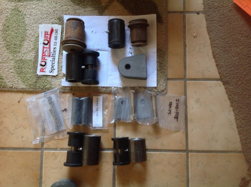

    Got sum parts in the mail curtesy of RuffStuff, love that place
    Lower arm pivots(2x.25"DOM), lower shock tabs, shock bungs for the top hat adapter, 3/8" thick tabs for making a lower jig, waiting on shocks, uniball spacers, steering extensions and axle shafts

    That Skycrane is awesome! Who's is it?

    The cranes are owned and operated by Siller Helicopters. Machine I'm on now is up in Columbia right now doin their fire thing :) usually were based in SoCal for the fire season

    My dad worked for Comlubia Helicopters for 20 years so I spent some time around their Vertol and Chinooks. They do mostly heli logging but assist during the firefighting season too

    Yea good ol shithooks, those field mechanics are tough folks, Columbia runs day crews and night crews, lots of Sheetmetal work. Crane just leaks and creaks like a big ol flyIn tractor, did sum loggin last winter with a s-61, fun times.
