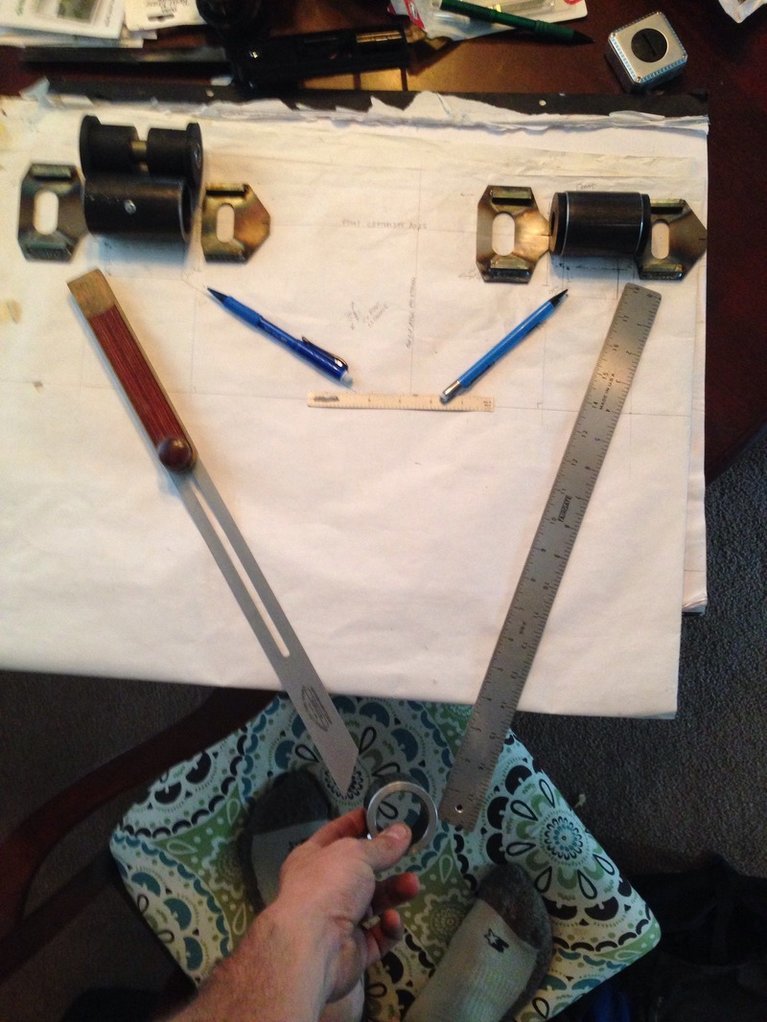

    That's the start of your jig to make to lower arms, right? Then the 2 pivot points there replicate what is on the truck frame? Looks cool, man! Often a full size drawing is the best way to eliminate confusion. At the small weld shop I used to work at we sometimes made full size drawings on the floor with soap stone of stair stringers, platforms, or whatev.

    Hey thanks! Yea I'm going to get it in the computer eventually, but the paper thing is the best for right now, easier cause it feels more tangible if that makes sense. Also, I used to fabricate bicycle frames for a short while and that's how we designed frames was drafting them, old school but works

    Reallll early stages, u get the idea tho lol

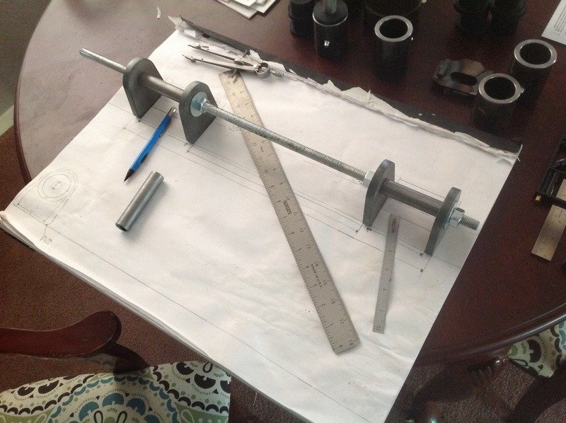

    Started the jig...bout as far as I'm gunna get till more parts show up

    Maybe you could weld that portion of the jig to a large steel plate. It would keep warpage under control and allow a place to mount the ball joint cup.

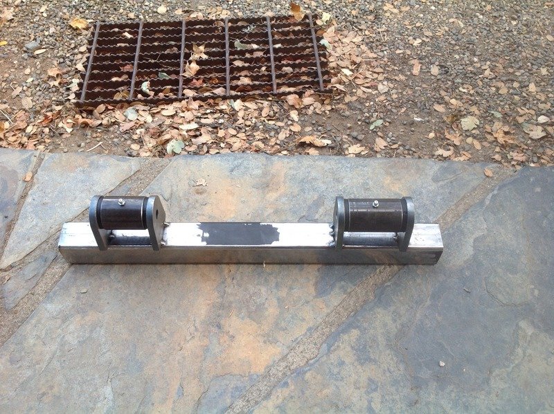

    I want the jig portable, gunna T off each side to pick up the outer pivot then gusset the T's triangularly with smaller box tube, I think it'll be sturdy enough, prolly tack it to my table on the ends too for good measure

    When it comes to jig making the sturdier the better. The pulling of metal from warpage can be significant. It is conceivable that the forces of warpage could distort the jig if the welding is substantial and the jig is lightweight. It sounds like you have a plan, don't be shy with the gussets!

    Yea it's gunna be gusseted, gunna TIG the lowers, if I take my time letting stuff cool it'll be ok I think, no problem spending a few days to weld em, TIG is fun anyway
