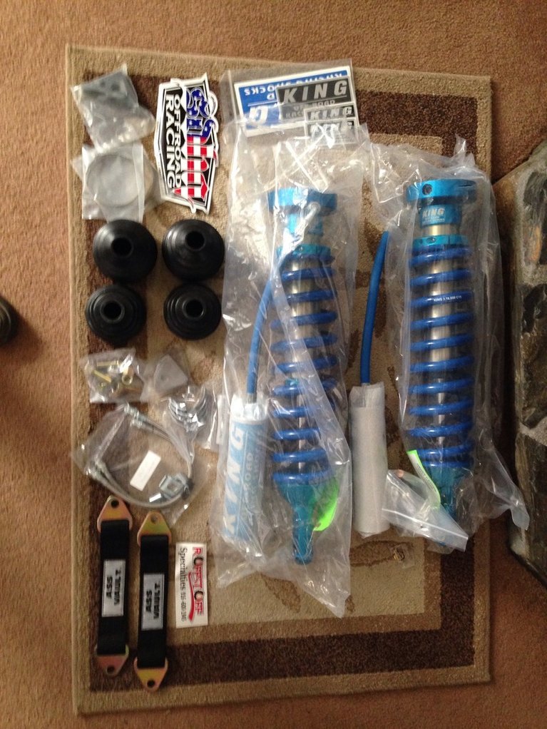

    Well after an engine change on the helicopter last night and a 7 am flight home, went and picked up the steel I need to make my lower arms, got this shit in the mail
    And drew up stuff to machine tommorow( lower spindle mount lug, weld bushings(so i don't melt rubber in my jig) and few other pieces to make my adjustable jig arm. Hopefully I'll get the jig/mock up arm made and working, then it's truck dismantling time!!! Oh and axles will be here tommorow

    Nice! I think King makes some of the best suspension stuff.
  18. Aug 19, 2015 at 8:31 PM
    #78
    Basikbiker
    Basikbiker [OP] Well-Known Member
    Sep 21, 2013
    #112968
    3,987
    Trav
    09 AccCab 4x4 spaceship
    My doors are the only stock things left besides the headlights
    I'm pretty sure I could be wrong but I think it's a proven thing lol
