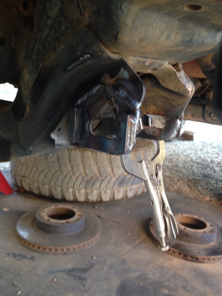

    And plopped this stuff on, coil bucket/double shear gussets are finished too today. Got a lot of little shit done today

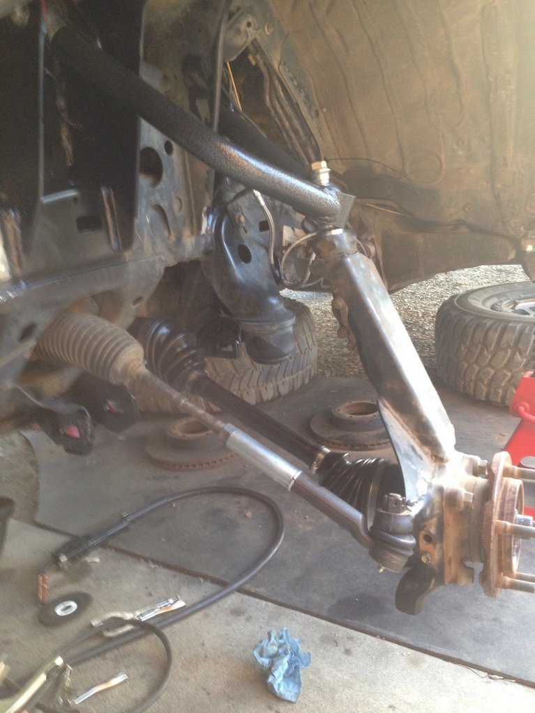

    Well it's 12:30am, couldn't sleep truck was bugging me about the steering, sooo, I re jigged the suspension and made sum angle of the dangle tweeks, truck can turn ALOT better now and the alignment is closer to stock but with sum added castor
    BUMP: 8.1* Castor, 5.5* Camber
    Ride height: 4.5* Castor, 1* Camber
    DROOP: 2.8* Castor, 1.6* Camber
    These are numbers with the cams centered in the tabs...I figure these numbers are a good center point for adjustability.
    Now I got to tweek my fixture a lil bit....that's why you tack shit first.

    1/32" toe in. Since truck is RWD (most the time) the rear tires "push" the vehicle which makes the front tires toe out on asphalt just a touch.

    If I remember correctly a little too much castor is better than not enough. More castor should help the vehicle feel more stable and steer more predictably, versus too little which can make it feel twitchy when under way.

    Yup, too much tho like wayyy too much and it'll shake, the more you have the heavier the steering is too. I made the tweeks cause I didn't like how the steering was at bump and droop I want the cv to be the limiting factor in everything so I can bump and strap to that

    Good thinking, if that wasn't taken into consideration you could be grinding cv joints when you droop or bump while steering.

    Yea and the misalignment on the lower uniball was really close to binding at extremes now it's happy the whole time

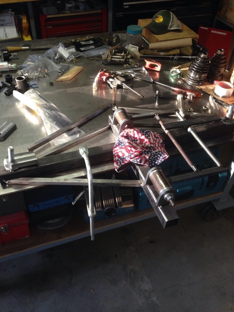

    Soo it "looks" like progress lol, gotta love VP, finished my jig, had to machine sum parts a little more here and there

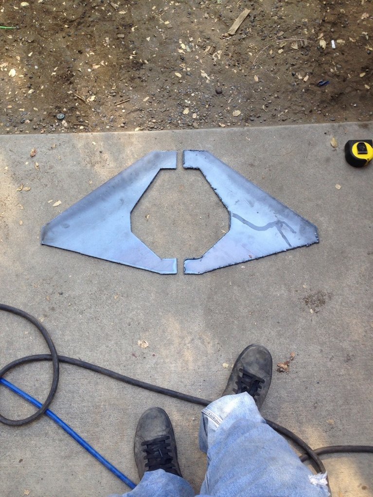

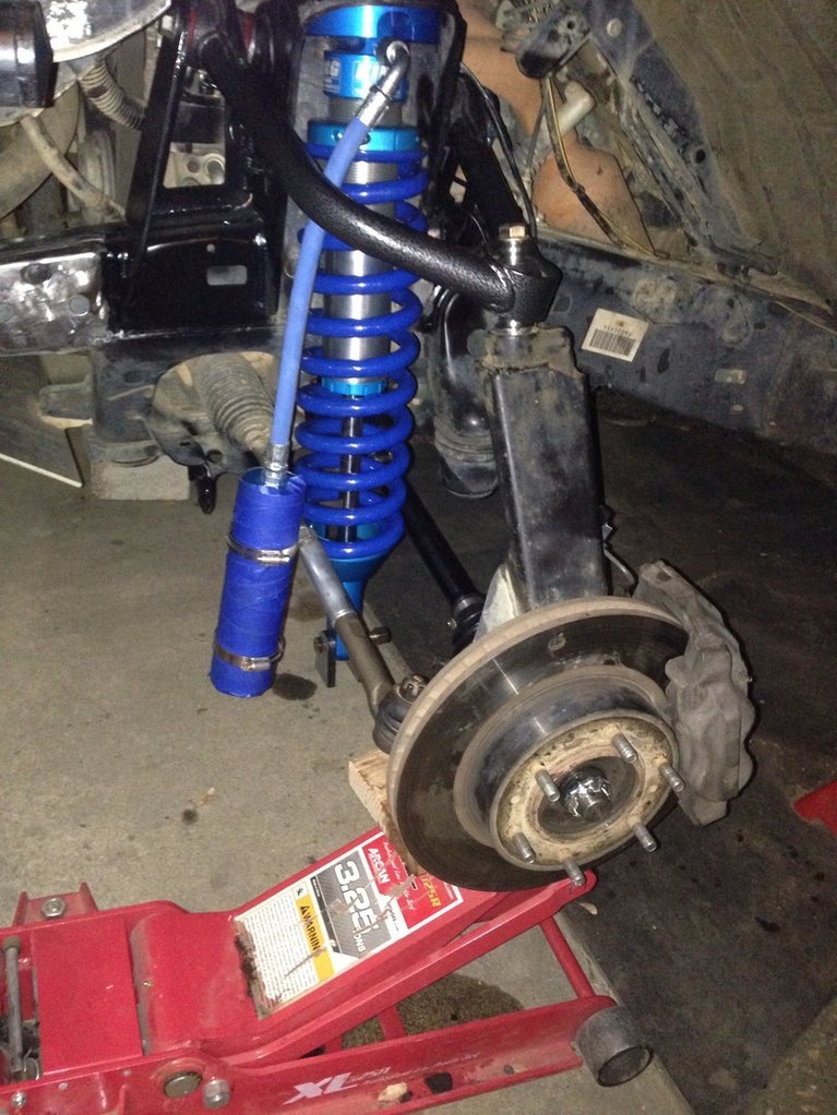

    Borrowed my friends plasma, started cutting out sum pieces, got the shock resi mounts burned on and mounted too.

    Cool. You gonna do some kinda internal gusseting? Did you ever consider doing tubing for lca like all pro? I think the plate design is superior, though. Seems inherently much stronger.

    Yea I almost went the tubing route but I think it looks kinda dumb, soo this way it is, yes all internal boxing n stuff
