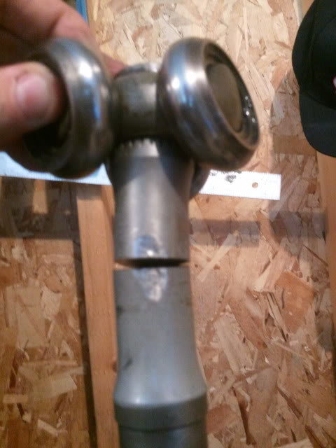

    You may want to pull your axles apart and check them. I ran th AP spacers with my ext travel Donahoes before switching to the Fox shocks.
    About 2 month ago I broke an axle. Turns out the Spacer+coilover combo was overextending the inner joint and worn three nice little stress rises into my axle shaft.
    Needless to say I now know that I have one axle still in the truck that looks like this :rolleyes:
