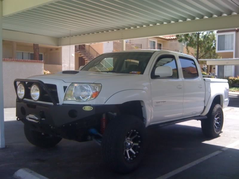

    '06 4x4 AP LT and Locked
    It looks fine, as you're keeping your stock fenders.
    The difference between AP LT and cranked CO's is about 1.5'' higher and 2'' wider each side.

    All Pro now offers glass fenders that come in at the front to line up with that bumper. :thumbsup:

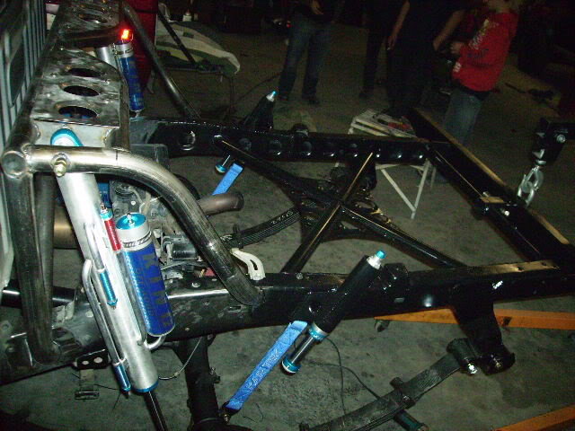

    I like this set up looks like the shocks are all the way up front to use most of your bed.(would like to see pics with bed on though ) looks like if worse case i can put my front quad tires on the metal shock hoop, and love the boxed frame and cross member.
    here is Jeff's tacoma from DMZ

    The glass bedsides go on really easily, especially when compared to the front fenders.
    The bedcages shown above are a heck of a lot more work/time/cost than the fenders will be. The Giant bolt-in bedcage is a nice solution if you don't have welding skills or a fabricator nearby. Just be sure to factor the time and cost into your build when you decide to take the plunge.
    To bedside or not to bedside is a decision that can be made after the fact. Install the kit, run wheel spacers if you run into clearance issues with the shocks, and only replace the bedsides if you rub and can fix it by cutting.
    Depending on shock choice you may get away with no spacers at all. Smooth body 2.5" shocks would probably clear without any issues. I'm running 3" 4-tube bypasses and have stupid-wide spacers for now until I swap rear axles.
