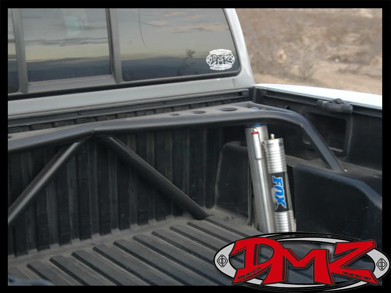

    wow he hardly affected the bedspace at all!:eek:
    what's the reason more kits aren't out there like this?
