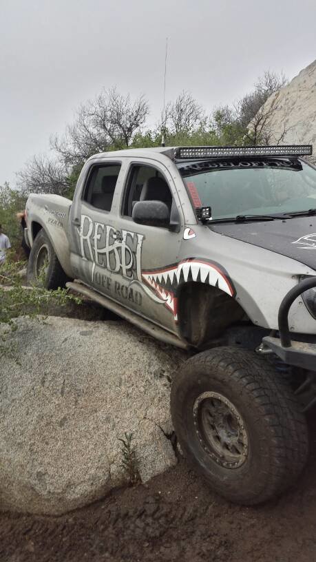

    Articulation is how your suspension flexes up and down, whether it's the front or rear. In the above photo, my rear suspension is articulating up, and front is going down.
    Also called full droop, or full stuff.

    Close, but not exactly. Most people thing travel in 2 dimensions, meaning up and down. Articulation, to me at least, means a 3 dimensional motion of each tire going from full bump to full extension in relation to the opposite side of the truck. Vehicles with solid front axles are said to articulate better because if one side of the axle is moving up (climbing a rock), the other side is forced to go down in an equal but opposite fashion. On IFS suspension or independent front suspension, like our Tacomas come with from the factory, each side is free to articulate independently of the other side, however, there are many limitations to how well it is achieved. I wouldn't say they're equivalent, per se.
