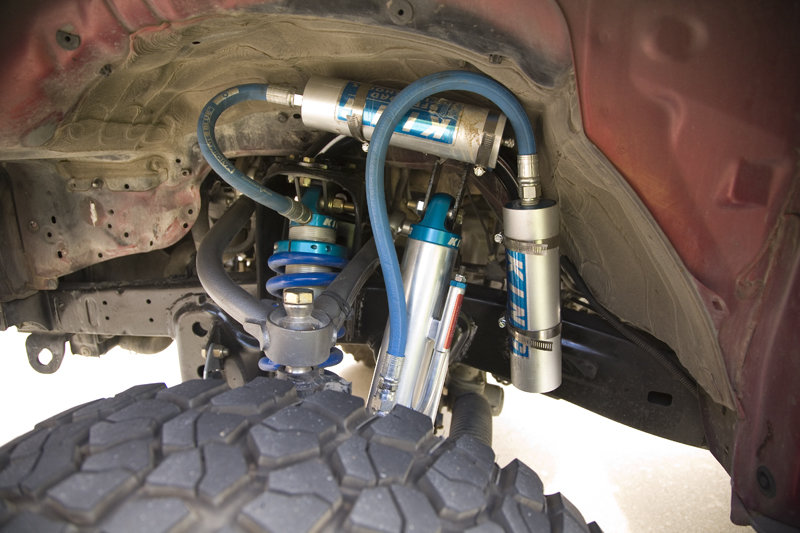

    as far as the mid and long travel are concerned.... what the difference in travel between the 2..?? if u guys have actual measurements that would be coo..?? and also i saw that Total chaos has a lower control arm that can mount a secondary shock to it without actually having to get the long travel kit... what do u guys think about that and is that worth it...?? sorry if these may be newb questions..??

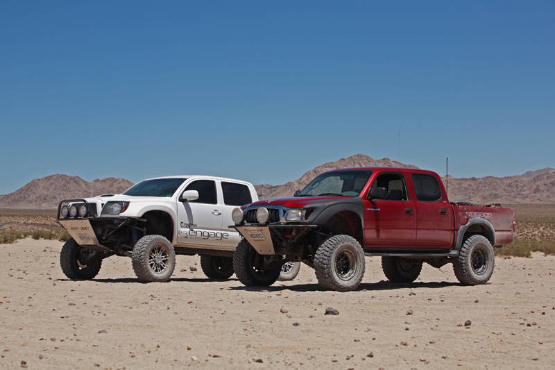

    i was gonna say, depends how you build it...
    im running King coilovers valved specifically for the Engage LT kit with King double bypasses up front...
    its a great ride both on road and off...

    mid travel is Nothing compared to true long travel, the number differences on a mid travel is about 8-(maybe) 10" as my LT kit cycles 16" which is practically double and handles Amazing off road. yes I believe every kit out there has a secondary shock hoop for the LT, idk what you mean by having the hoop but not long travel? Engage's LT kit pulls the most travel (16") out of all the bolt on kits out there, you can add a bypass hoop and bypass like mikes (red) truck above, I have the hoop installed, just waiting to finish the rear, then buy bypass's and throw them in

    he will be soon :D

    dangit Kit... you were supposed to keep it on the downlow... ahahahaha
    i have been running Deaver 8 leaf packs with Donahoe rear resi shocks...
