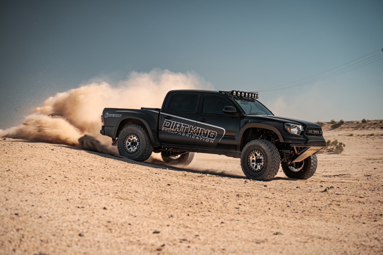

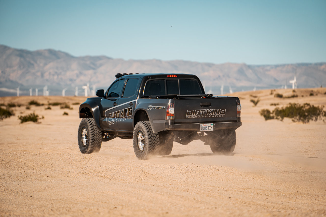

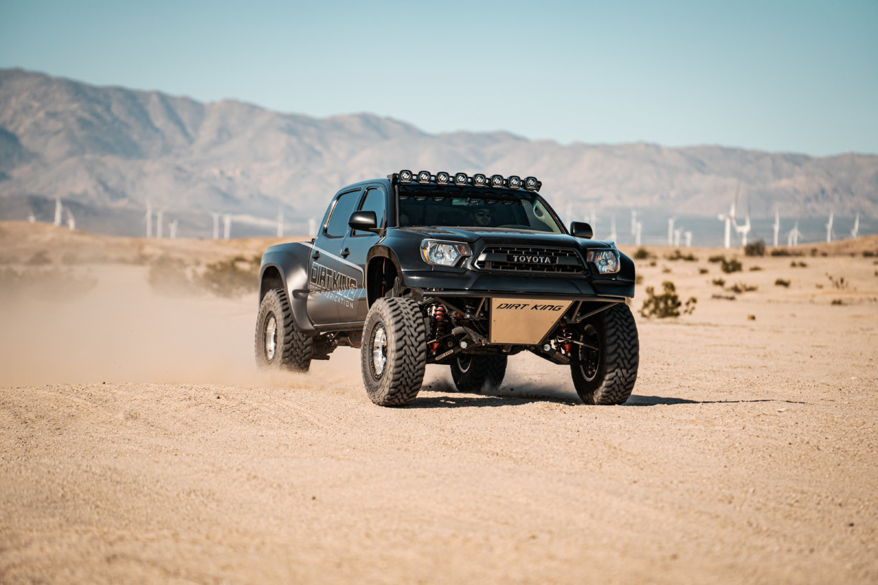

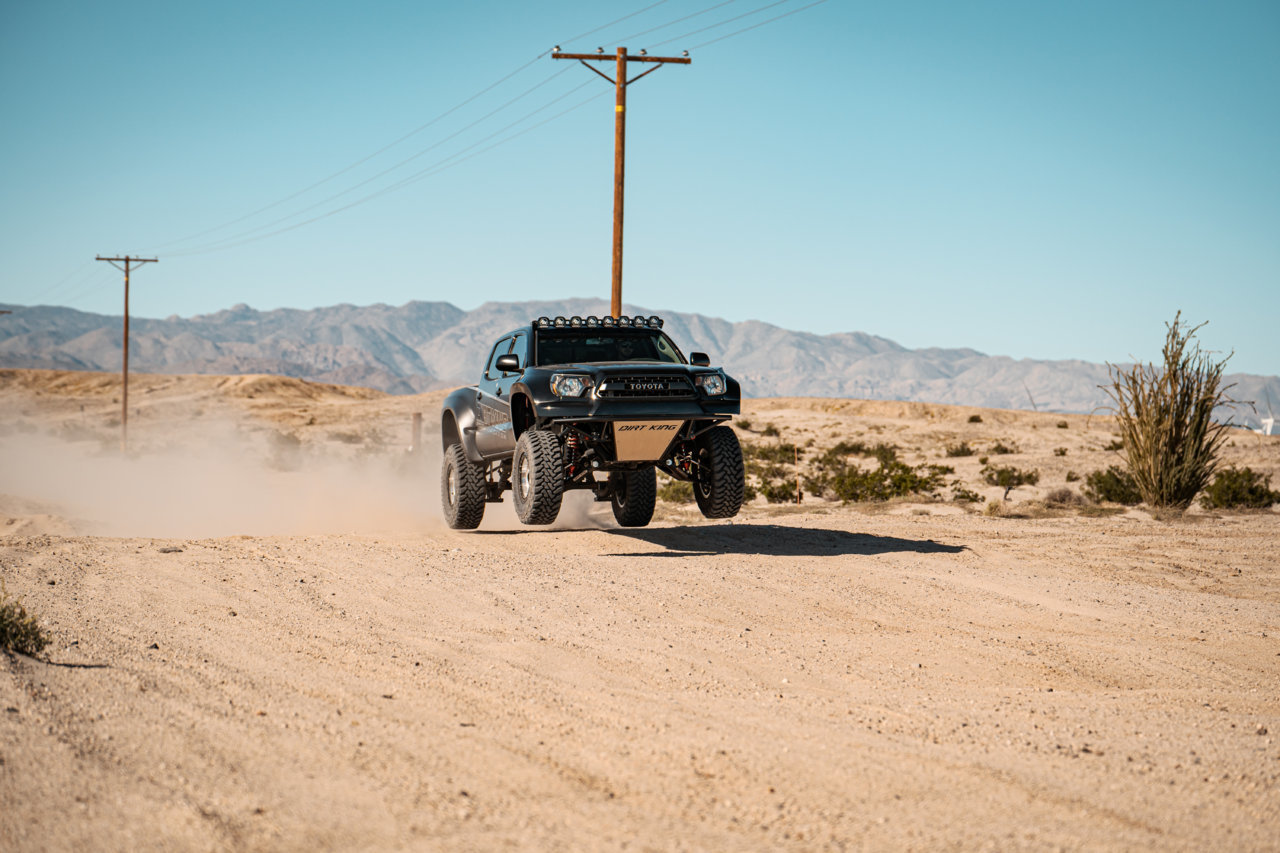

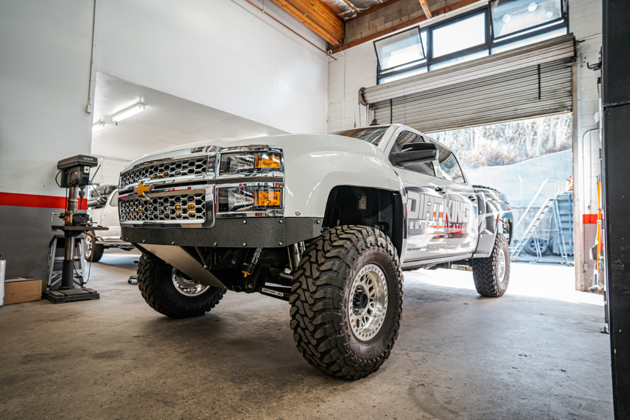

    We offer both a Long Travel frontend and a Spring Under rear setup for that truck. The frontend can be 90 percent bolt on with the exception of limit strap tabbing. Once you start to get into UCA double shear kit, spindle gussets, bypass hoop, and alignment cam gussets is when there will be a higher level of fabrication involved. All these add ons are highly recommended and we suggest installation be performed by a skilled fabricator. The factory spindles are forged from the manufacturer and the spindle gusset kit helps further strengthen them, a gusseted spindle can handle a ton of abuse. As far as the rear goes I would advise against a 4.0 bypass, on a midsize truck we suggest 3.0 or even 2.5. The 4.0 has such a high volume of fluid the light weight of a tacoma has a hard time displacing so much fluid and moving the piston that tuning will be very difficult. No matter how hard you run you will almost never experience shock fade on a 3.0 rear bypass. We developed our spring under kit 3 years ago and have done a TON of testing, I would put our SUA kit against anything on the market.
    Heres a quick installation on out LT kit
    https://www.tacomaworld.com/threads/dirt-king-long-travel-suspension-install.555489/
    And our SUA kit (keep in mind SUA with frame plate kit, notch etc is a lot of fab work and setup)
    https://www.tacomaworld.com/threads...fabrication-spring-under-installation.730155/
    Heres some photos of our Plaster City tuning trip earlier this week. If you have any questions about any of our products feel free to email our sales team at sales@dirtkingfabrication.com or 619-944-8913.
