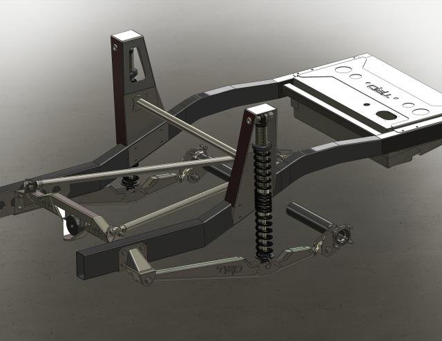

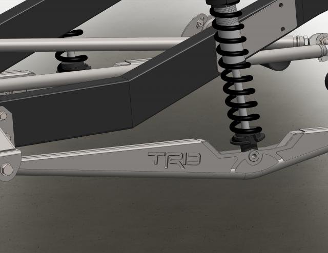

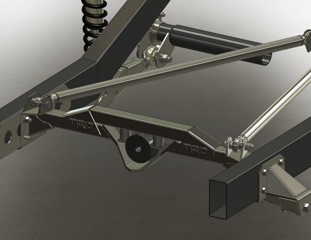

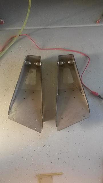

    Last photos for the day.
    I'm pretty happy with the shock towers. Although they look massive in the model, they won't be once installed. The crossbar fits under the bed and the image showing the shock coming through the bed is as far as it will protrude, which hides well below my tool box. As with all my builds, I try and hide and keep things looking as stock as possible.
    and don't mind the rectangular tube object thing in the bed, that's my fixture to let me remove the bed easily with a cherry picker since I've only had it on and off about 10 times.
    Also, a requirement for this conversion is boxing the frame. I did that several years ago so it isn't covered in the build up.

    That looks so awesome! What software do you use? I use Inventor at work. And did you draw up the truck frame yourself? take dim's off your truck and draw it up in 3D? Sub'd!
  8. Jan 4, 2015 at 3:30 PM
    IFS4LIFE
    IFS4LIFE [OP] Well-Known Member
    Jan 4, 2015
    #145593
    120
    Tucson
    98 Tacoma 4X4
    Stock.....ish
    It's SolidWorks. For the straight sections of the frame it's all tape measure and caliper. For the curved section I made a template and traced it in SolidWorks.

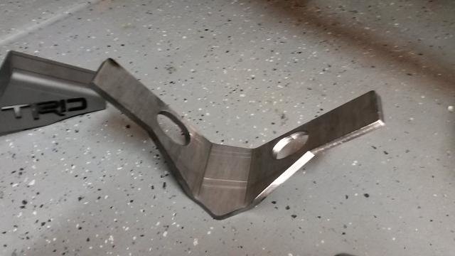

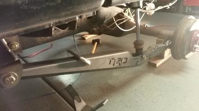

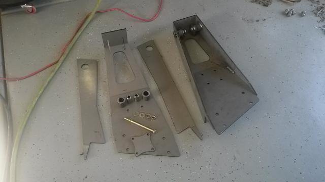

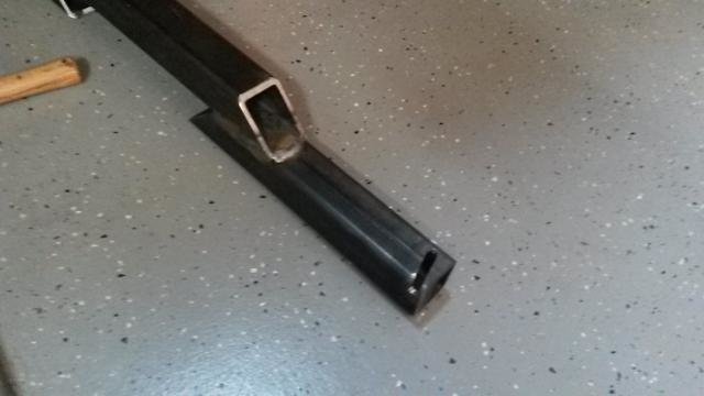

    A bit more work done tonight
    Crossmember notched and ready to go around the upper frame mount link tabs
    A better image of the lower frame link mounts in position. I may end up moving these flush with the frame on revision 3, but that hurts the geometry so we'll see how bad of a rock anchor these are for now. I feel with my sliders back on the truck they won't look or act as obtrusive.
    Crossmember in place before initial welding
    The crossmember after I added the gussets. I burned in the 2X2X1/4" wall to the 1/4" plate as deep as could while being upside down under the truck with a Miller212 before adding the gussets around the joint. These will get fully welded on the bench next time the crossmember comes out from under the truck. It would probably hold w/out the gussets, but I like redundancy.
    A better shot of just how far out the lower axle link mounts are. They actually use the backing plate bolts to locate them before final welding to the housing.

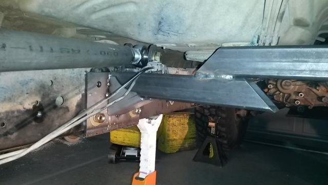

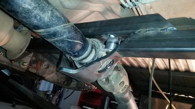

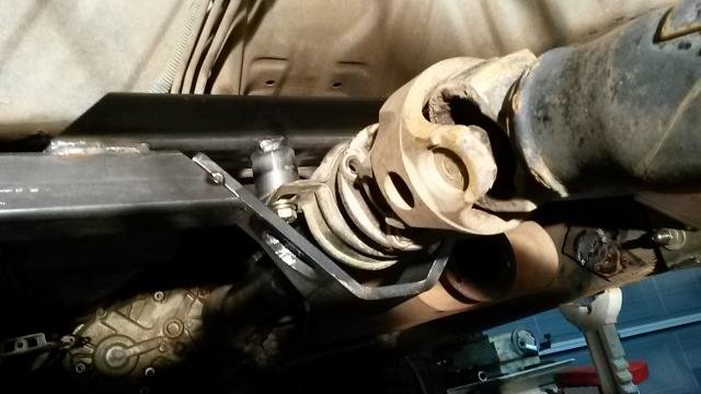

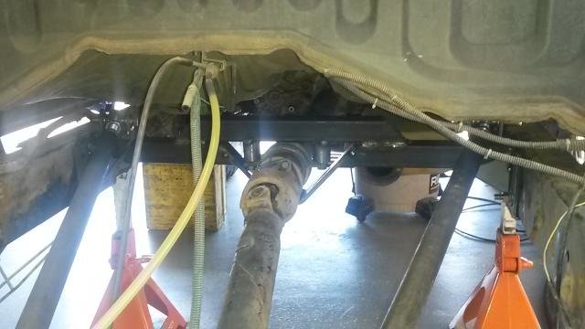

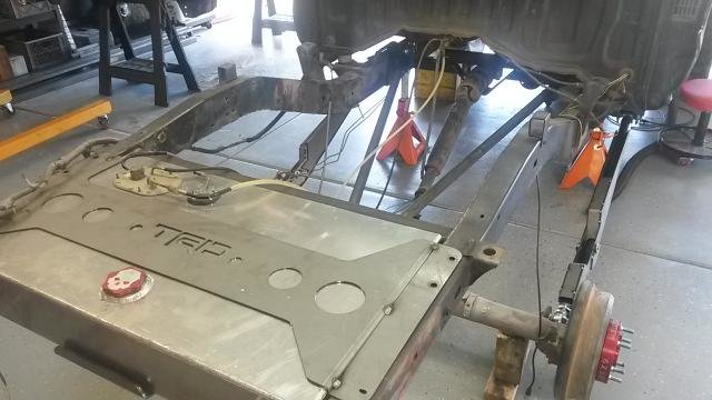

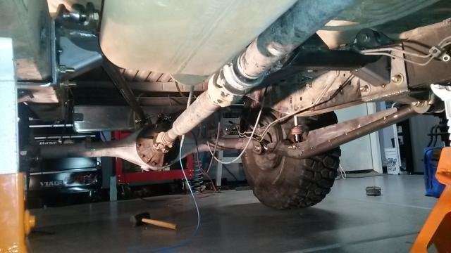

    and more progress tonight. Got the driveshaft mocked up. Looks like the angles are close. I might end up making the upper links just a bit longer. Running the 2 piece drive shaft is really what's going to limit the travel overall, but there isn't really much I can do about it. I'll still have more than I started with and the ride quality over the leaves should be infinitely better.
    With only 10.25" of shaft showing, another 3.75" to go before full droop.

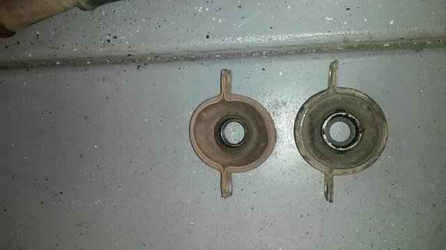

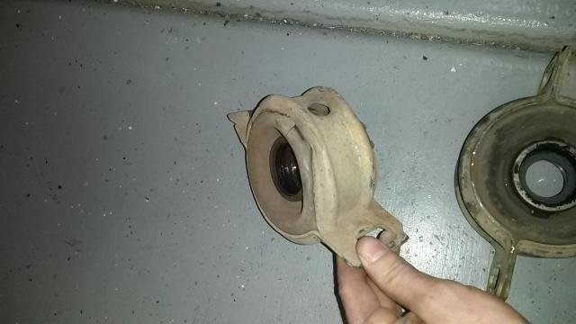

    Carrier bearing mounting posts
    The carrier bearing I've been running for the last 3 years, hence the overbuilt, overkill carrier bearing protection crossmember.

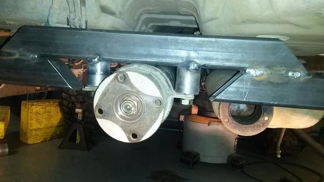

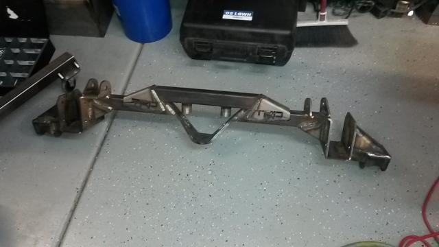

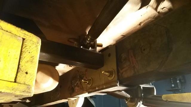

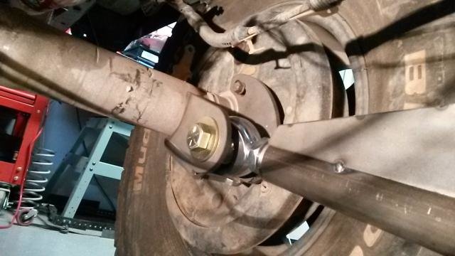

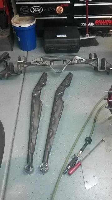

    Carrier Bearing Skid
    Some more carrier bearing crossmember gussets

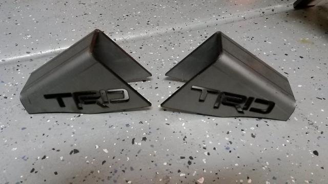

    Trailing arm outer panels
    Ncska21 and Pirhett like this.

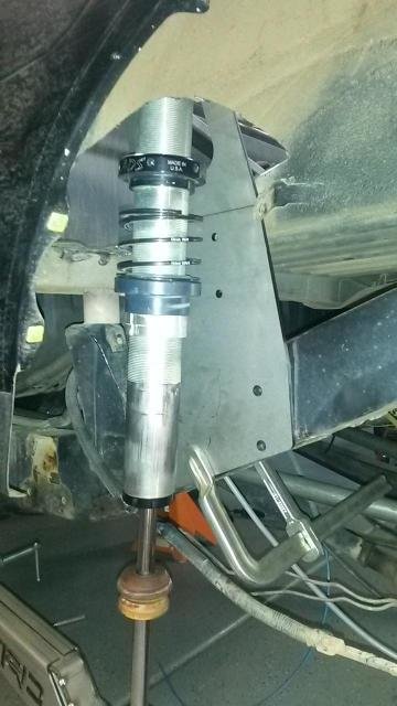

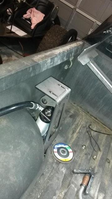

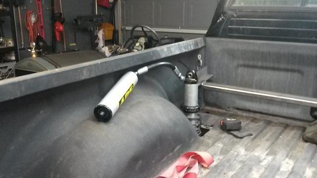

    A bit more work tonight. Just had the towers clamped to the frame, there are plenty more gussets to add, but they do fit.

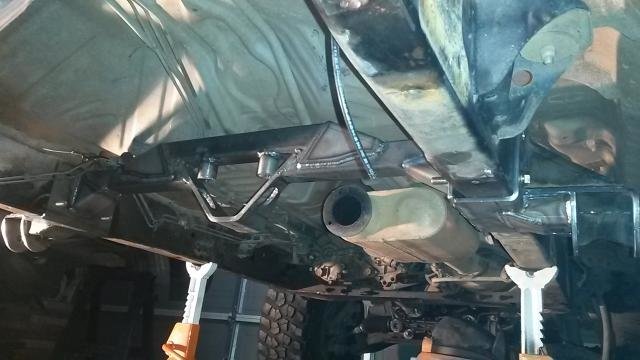

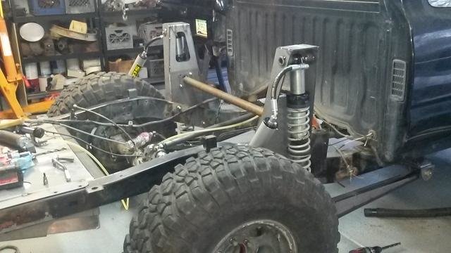

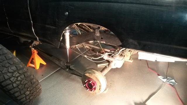

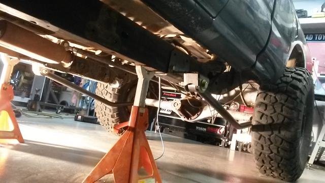

    Just a bit more chugging along this weekend.
    Back on it's own weight! Finally!

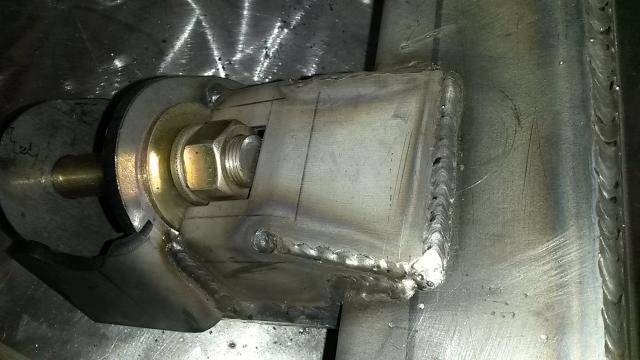

    Just a lot of welding going on tonight.
    About 2/3 done with the crossmember
    and about 1/2 done with the trailing arms

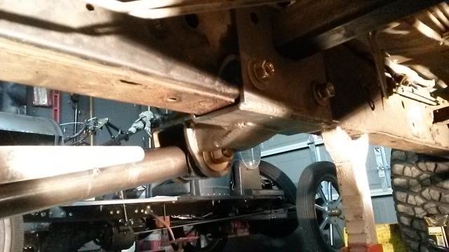

    Finished welding up the crossmember and drilled the last of the frame holes tonight. It's mounted for the final time before the test run. It'll have to come back off once again for powder coat, but that'll be in a few weeks.
