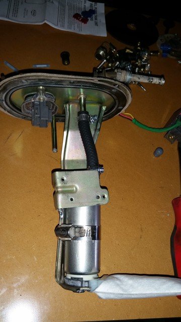

    Part of the modded sending unit and pickup for the fuel cell. Finished photos tonight with the new fuel pump.

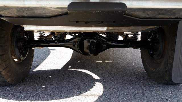

    Good to play in the water this weekend.
    The links and shock towers still aren't coated but they'll get sandblasted again anyways. The rear axle won't so I had to make sure to get it protected.

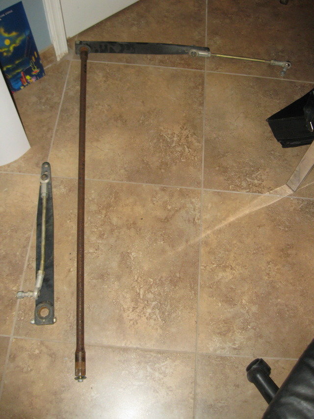

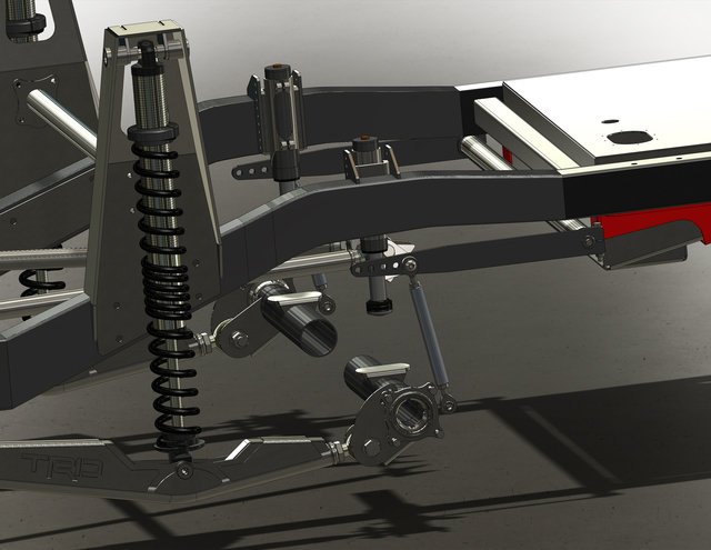

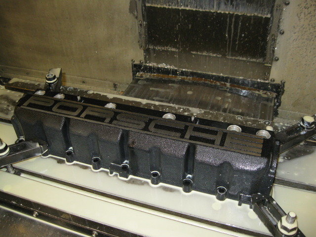

    Did some work on Porsche parts today
    and picked up a Currie sway bar to put on the Tacoma. Modeled it up tonight and got it in place. I'll design the mounts tomorrow or so. It will be nice to have some more stability at speed.

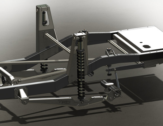

  20. Jul 19, 2015 at 9:51 PM
    #200
    IFS4LIFE
    IFS4LIFE [OP] Well-Known Member
    Jan 4, 2015
    #145593
    120
    Tucson
    98 Tacoma 4X4
    Stock.....ish
    Got some more hardware placed in the model tonight and some tabs drawn for the lower swaybar mount. Should have this thing on by Tuesday.
