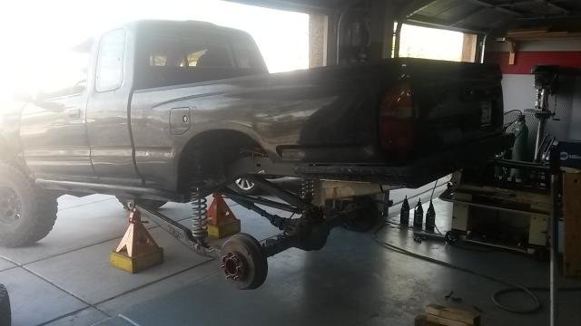

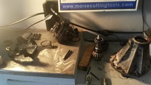

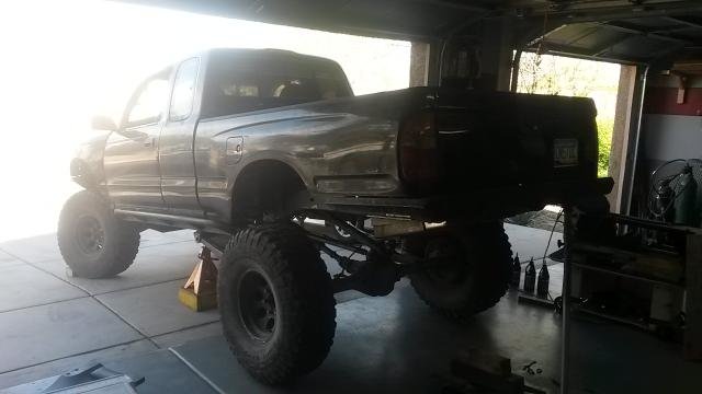

    The bad news is the rear end was a ticking time bomb. It'd been getting louder and louder. So I pulled it apart and all the bearings were hurt. I figure I didn't get the housing clean after sand-blasting even though I cleaned on it for about 4 hours, so I'm going to replace the bearings and build a full width housing using T-100 shafts. It'll be a fully fabricated housing so it will be an upgrade in strength over stock, and I won't have to run the wheel spacers any more.
    I can't get the tires off of the grand without a lift or cherry picker any more
    Dropped out
    3rd Member in pieces
    A better image of the lower axle link brackets out on the backing plates
    How she currently sits

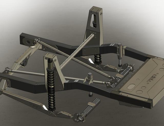

    and updated the CAD model tonight with the bump cans and mounts.

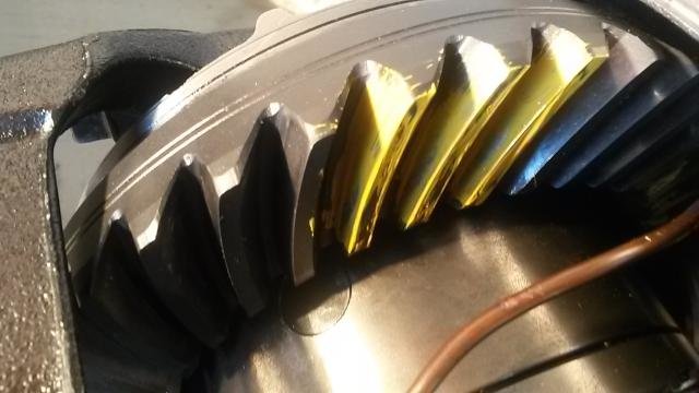

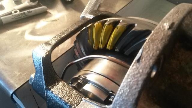

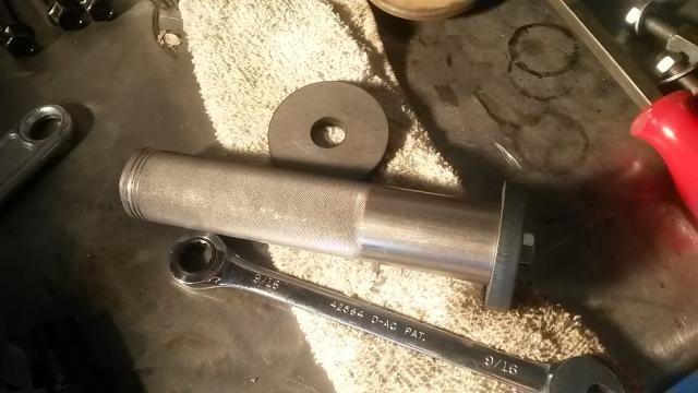

    Needed a beefier bearing and seal driver for the 3rd rebuild so I made one.
    The good part is I can laser cut dies for any size bearing or seal now without issue and I know they'll never fail. I wonder how many I'll get up to before I kick the bucket.
    The knurling process for those that are interested
    Coast Side
    Drive Side
    back together
    PPL was 19 in-lbs dry, 17 wet before any run in. Back lash was 0.006" and I pre-loaded the carrier bearings a bit more than they were when it came out. Pinion checking depth was accurate to the thousandth. Overall I'm pretty happy with the setup. The only way I could get the housing clean though was to pull it and hose it for about 20 minutes before I was happy with the results. Not ideally what I want to do on a bare metal housing, but it had to be done. I also started the design on the new fabbed housing. Pics to come.

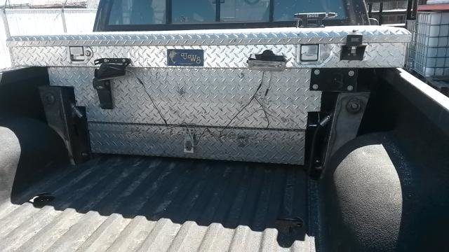

    Just need a little trimming on the tool box.

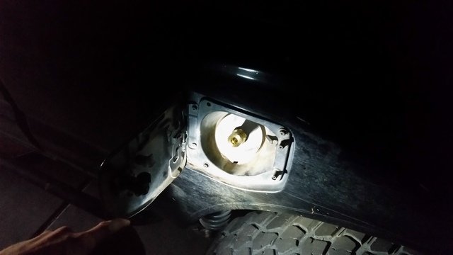

    Been swamped with other projects lately but I did get the OBA hooked back up last night and found a new sweet spot for the quick connect, since I no long have a stock fuel neck.
    Will work on the gas tank quote as soon as I can.

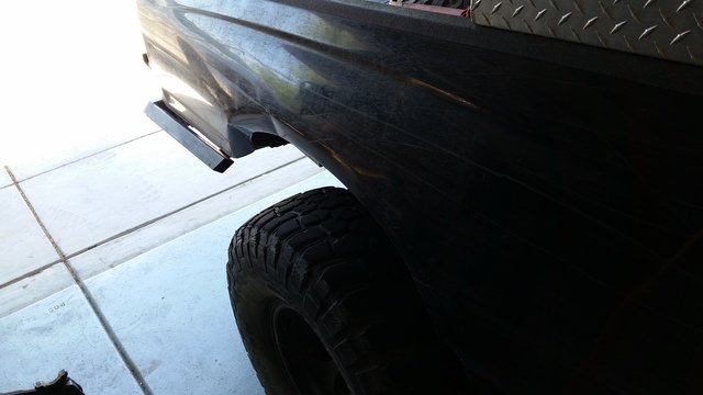

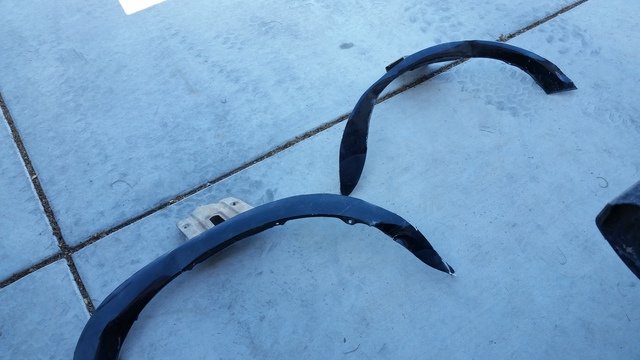

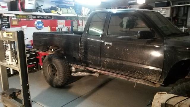

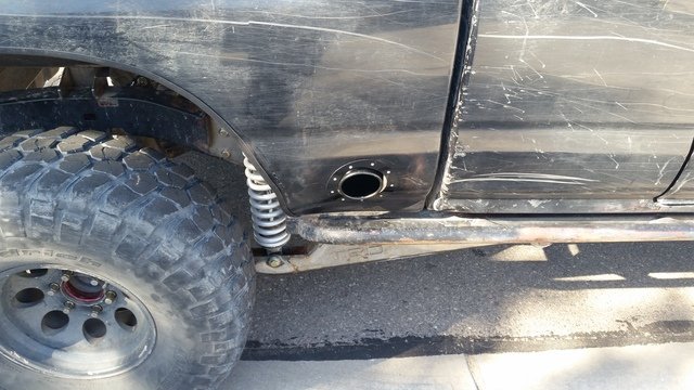

    After our last run out with the bed, I discovered I had severe tire rub issues, so I came home and fixed that.
    and after adding the spare tire, it is sitting a bit low so I am going to have to up the pre-load on the rear springs or change the rates as I still have about another 300 lbs of shit to add to the bed.

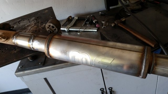

    Also, swapped out the flowmaster 40 for a 2.5" Magnapack. Much smaller and sounds better.
    Also completed the rest of the exhaust. Sounds better than ever

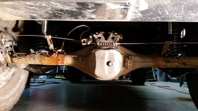

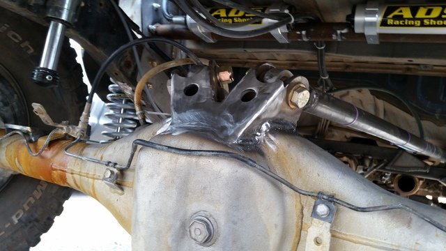

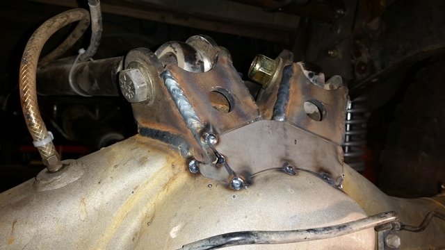

    Finished molding in the rear upper link mounts to the diff. housing. They need a bit more clean up, but I'm not worried about them bending anymore. (Also, on that note about housings, I've started working on the front end of the truck again since it's severely lacking before continuing with the custom rear housing as it's not necessary at this point since I got it moving again).

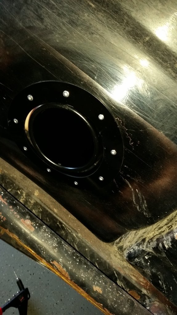

    and for those wondering, pricing on the Fuel cell and cradle would be in the $500-600 range without the sending unit mods. I am working on how to make this work without any modifications or an easier drop in unit.

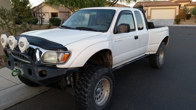

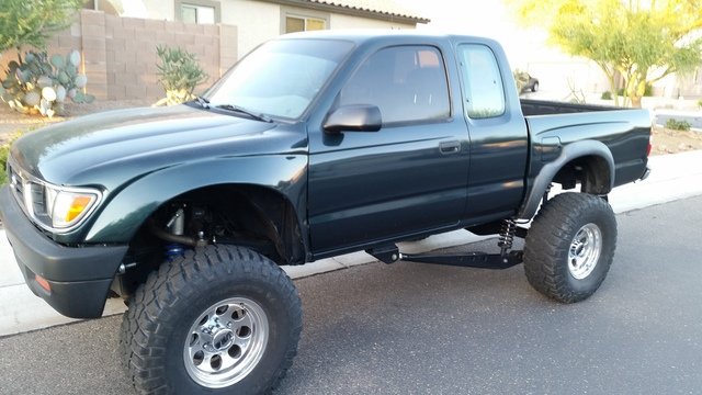

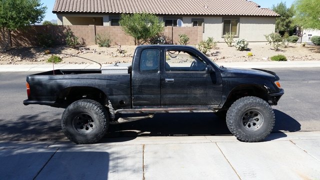

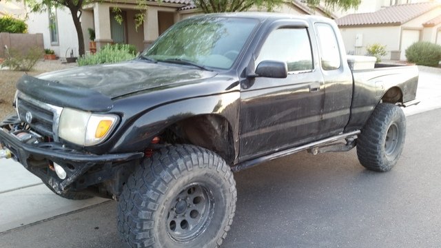

    and just for fun, we had 3 very different builds in front of the house the other day.
    S/C 3.4 Camburg front with Deaver 62" rears setup for overland and trail riding
    Turbo 2.7 Clown Car running my Long Travel MRK 1 Front setup and MRK 1 Trailing Arm Setup in the back, setup for go fast duty only
    and my Stock 3.4 Gen. II Rear Trailing Arm Setup pair with a stock front end for crawling and long range adventures.
