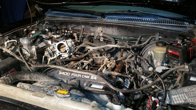

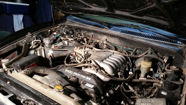

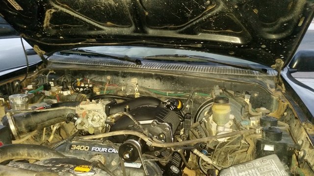

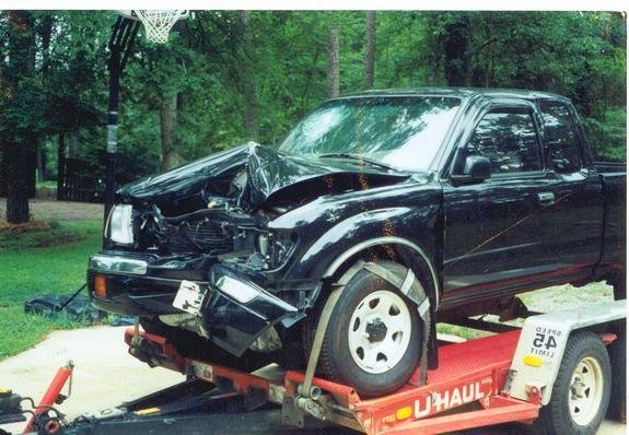

    From This
    To This

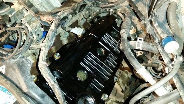

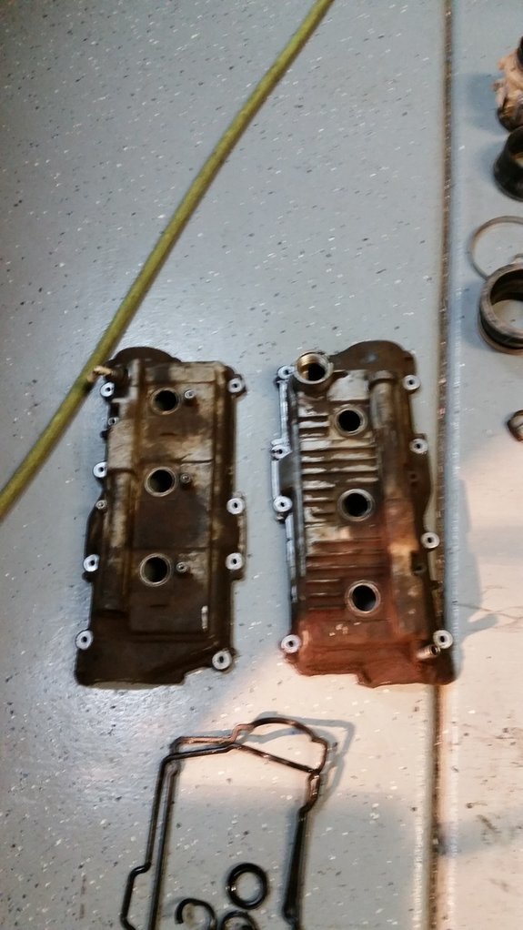

    The last time I had the intake plenum off it looked like this 14 years ago, the day I brought it home
    From the bottom w/out the skid plates
    Going to take this opportunity to pull the valve covers tonight and replace those seals as they've been getting progressively worse. Not bad for a motor that has 185K and a head on collision on it's record though.

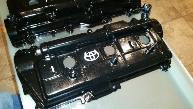

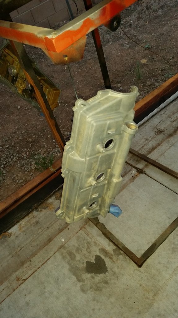

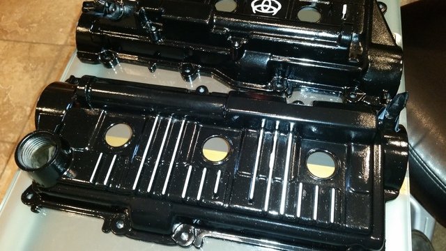

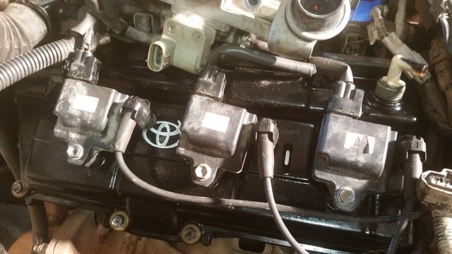

    A little bit of Valve Cover work
    and some custom vinyl for the windows

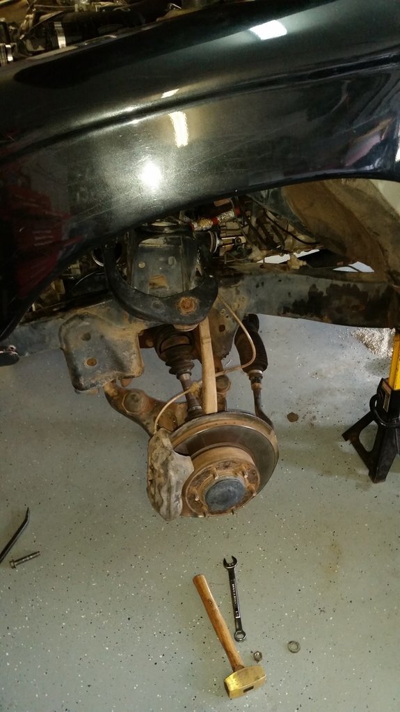

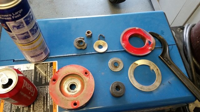

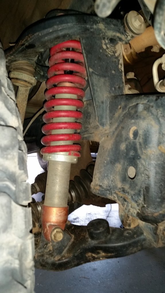

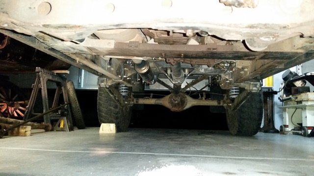

    Developed a clunk after the last trip to the mountains. Figured out it was in the top assembly of my ancient Sway-A-ways. I've dealt with a few coilovers and these have required less maintenance than any of them. It seems the upper bushings have had enough.

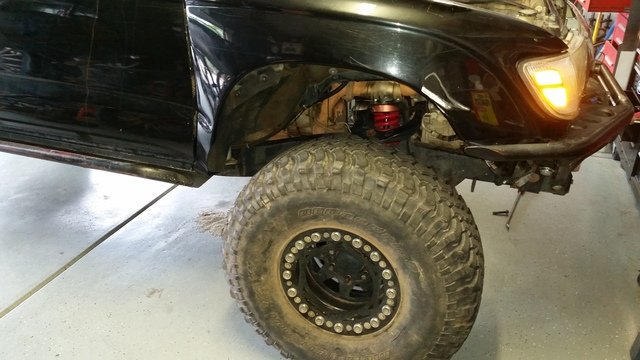

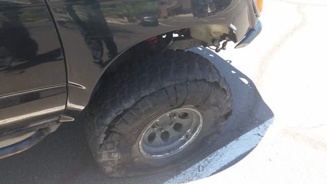

    Blew a tire this weekend
    Running this awful spare
    I wish BFG would have stayed with this pattern, but the weld on beadlock experiment is about as bad as I expected. It's heavy and un-balancable at any speed.

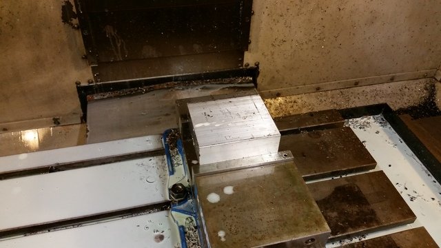

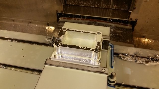

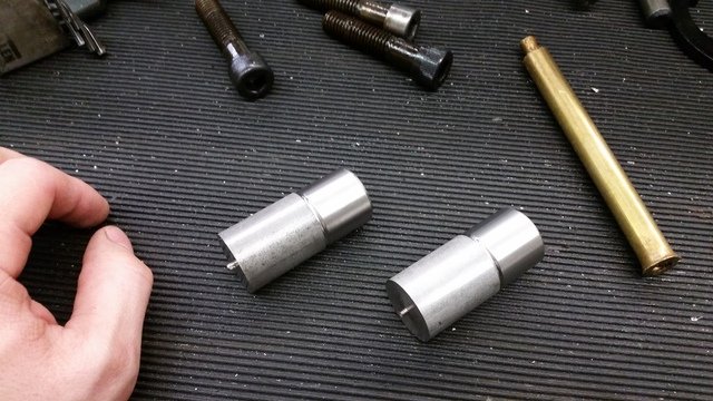

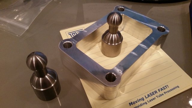

    and while I'm waiting on parts I figured a S/C isn't much good if you can't get through the gears so I started machining short throw parts today.
    As soon as my lathe frees up I'll make the rest.

    Op 1 of 3 for the extension done. 303 SS and I'll make the bushing bronze.

    and I felt ambitious so OP 2 is done as well

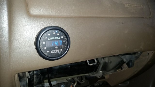

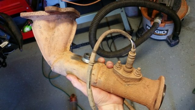

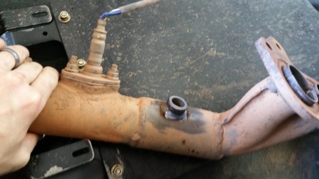

    Yay for stoichiometry. AFR is hooked up, waiting for the boost sensor to come in the mail so I can see where boost is at. It and the 7th injector kit should come in the same day. Truck isn't mobile right now anyways.
    Custom Down pipe from previous mods.
