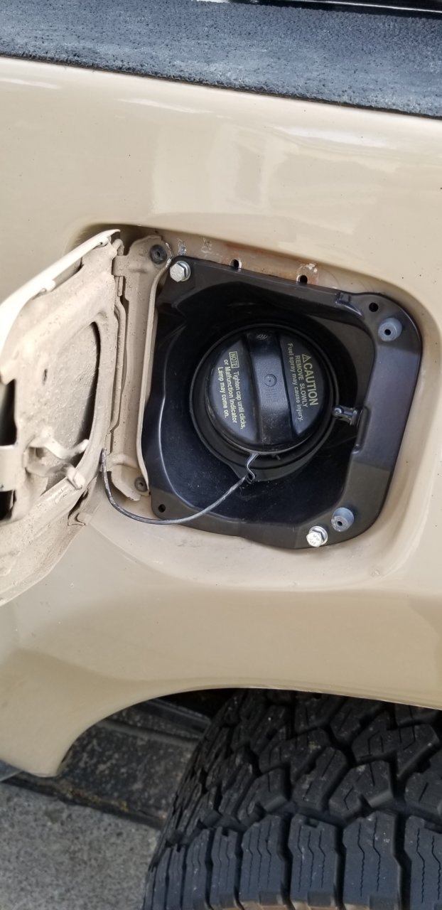

    Had some random power loss issue when cruising on the freeway. No CELs just would act like it was misfire or something. Just swapped out some possible issue items. Still testing to see if it's fixed.
    The fuel filler line was routed a kinda weird route due to the coilovers and bypasses. Had extra turns and the main line in was kinda pinched. Used the 4 runner inlet tube and modified the OEM filler neck to work in a better route. Also redid the shroud at the top as I was cut prior. Not it's back to OEM to protect the gas cap from mud/crap.

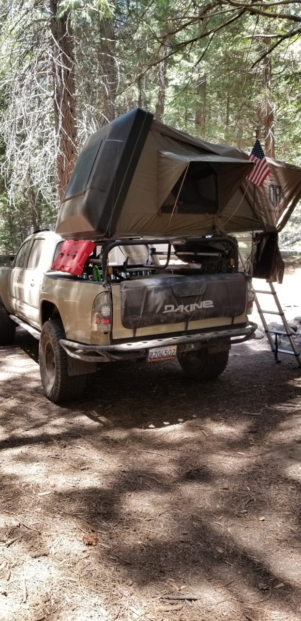

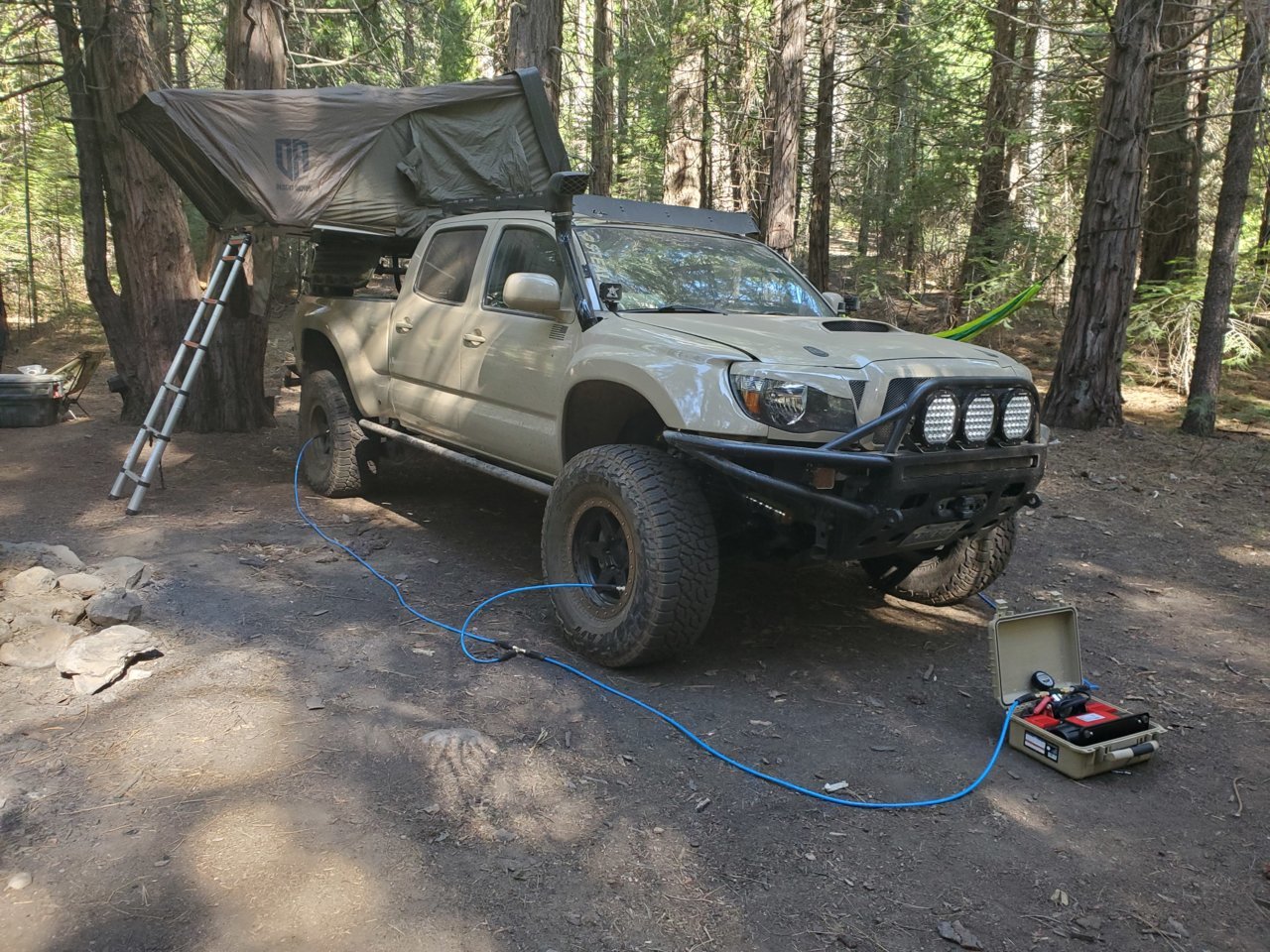

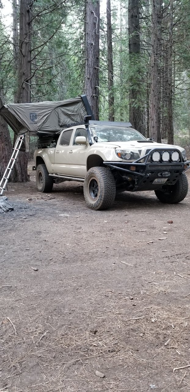

    Couple more from last trip.
    tacomgee, rob1208, ChadsPride and 3 others like this.
