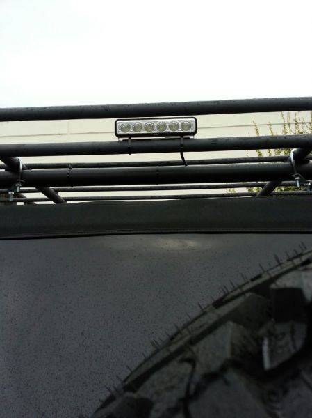

    sweet truck! do you have to cover up those led lights when your on road?

    Thanks, I don't and hopefully it won't be an issue.

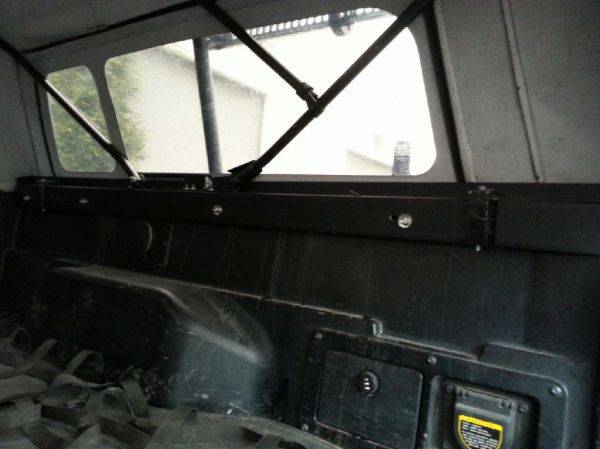

    hey awesome truck! do you have any pics of how those bars are mounted to the bed to support your roof rack? i have an A.R.E. topper that i was gonna just put my safari rack off my rover onto using a thule system or something but i really want to be able to support more weight and not have it rest on the topper.

    Maybe this can help you out:
    Look for a more detailed write up soon.

    Hard to see whats going on but thanks! Im guessing theres a thin plate of steel that rides below your topper then extends just a little past the side amd your bars weld to that? Idk thats the only way i could think to do it. Thanks!

    Correct. Used 3" Angle Steel welded to 3" Flat Steel. Cutouts for the clamps and holes where the bolts for the T-slot nuts go bolting it to the rails.
