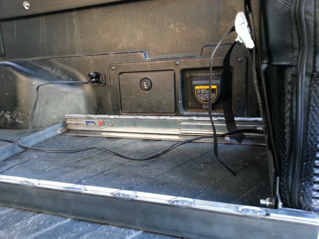

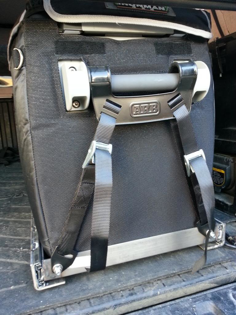

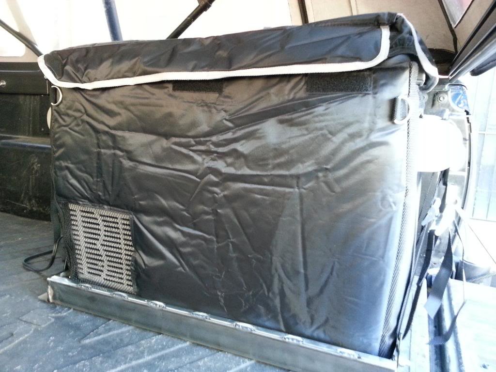

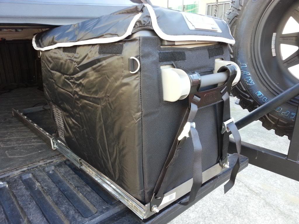

    Finished building a slide out for my fridge! Big thanks to my friend Alec!
    Used:
    Angled Steel
    Ball Bearing Drawer Sliders
    Flat Steel
    ARB Tie Downs

    What was the load rating on the full extension slides you used ?

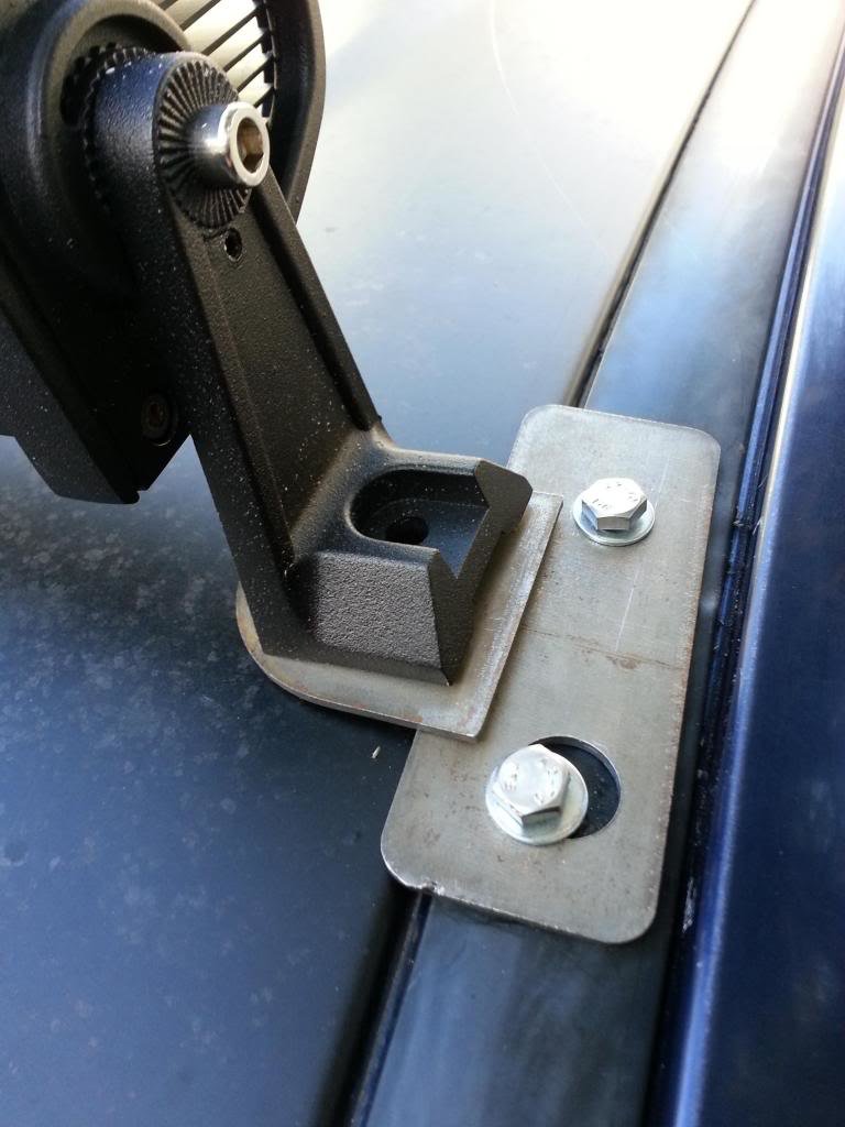

    If you get an oppurtunity can explain in a little more detail about mounting the light on the roof.

    Thank you sir. As for the light mounting, I just bolted some plates to the OEM roof rack holes. Then mocked up where the light would go and tacked another plate to the first one.
    Here you can see:
    After that we tacked on a bolt so the mounting bracket from the light would sit on it.
    I ran the power wire up through the space in-between the windshield rubber.
    And that's pretty much it.
