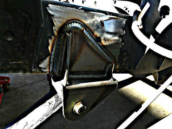

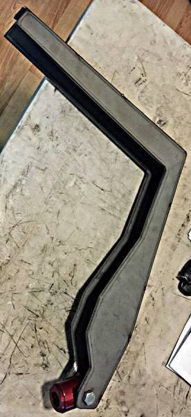

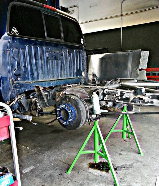

    Got some pictures from them today.
    New DMZ front hangers
    Shock Mount for the bed cage:

    The new rear frame, boxed, and new cross-members.

    More updates from today:
    The rear at full bump, metal to metal. Will be bumped an inch or more lower.
    Better view of the new rear shackles and hangers from DMZ.
    Fully boxed rear half of the frame to the end...

    How far forward did the go with the frame boxing?

    about where the cab starts.

    some great looking work!
    those DMZ hangers look amazing as well
