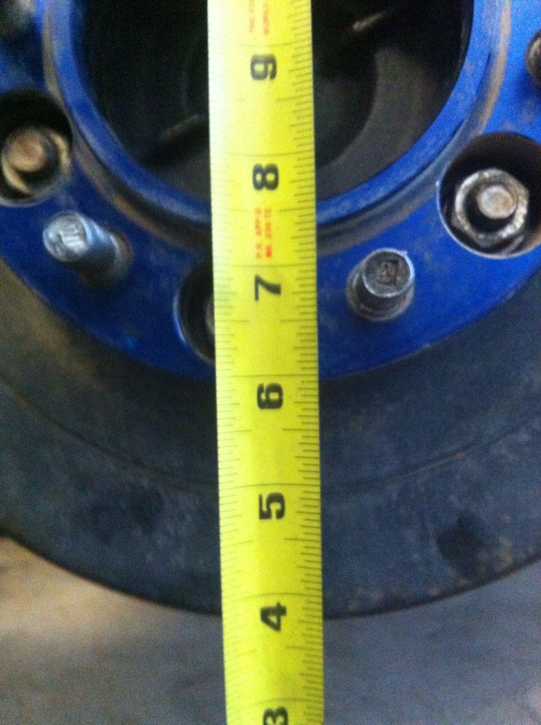

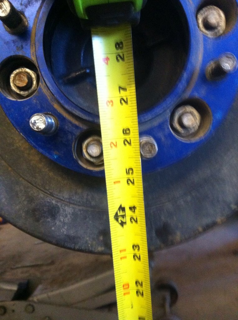

    I got almost 19" metal to metal with the 50T pack and 12" over the frame shackle with a proper 52.5" front hanger to shackle pivot after I ditched my F67s. The 50T has at least 2" more droop and with at least 1" negative arch. I could only pull 16" with F67's in the exact same configuration and that's if I stood on the axle to droop it down.
    69A1FBDA-2658-40AA-A447-92948B5C91CD-482_5b302a5c8199cc3a563e7409946cc687482e5d59.jpg
    398EA09B-870B-4D6C-8EF6-60C3B084E45C-482_70e7031ce2dcac4b68487d9856e50003f7dd7b79.jpg
