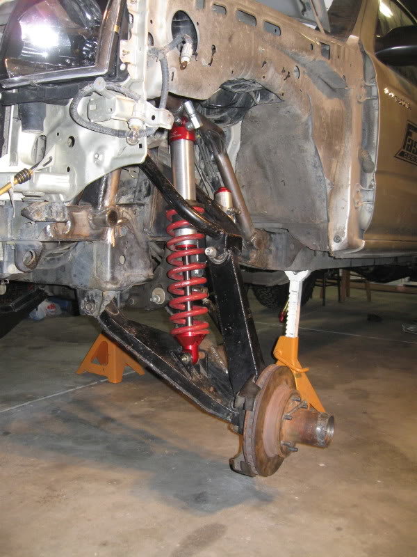

    probably a dumb question but how do you achieve so much travel? all you guys are pulling like 14-16 right? hows he pulling wayyy more than that?

    yeah dude, it's a sick truck. i'm following hsi build very close... getting ideas from him for my bedcage re-design and cab cage

    wider arms: TC and camburg kits are 3.5" over from stock, his kit is prob 5" over and his upper arm pivots off a verticle uni-ball. all "production" kits: TC, camburg, engage are all verticle uppers and lowers

    isnt this the same thing then?

    my bad, i ment to say TC, camburg and engage are HORIZONTAL uppers and lowers... stupid beer :D

    lol okay thats what i thought haha once again you know everything:D so the only way to have vertical uniballs is from a custom made kit?

    yes, because they require custom spindles, as you can see in the pic

    Ya pretty much custom uni ball mounts on the arms also the spindle needs to be custom. I'm not positive if guys use the vertical unibals on the lca but I know it's popular for the upper arm. Matt is right they come on wider kits and or race kits. I just had some "dessert" Krish that's why I haven't texted by FYI haha

    I know a guy who does Cnc work and made replicas of the icon ucas Krish. He says he wants to try for us maybe. I told him make us an lt kit. Depending on weight

    yes, but the dude that i was going to have build it, closed his shop down (voluntarily) to take on other projects (bigger money)
    i wanted something like mike's kit... 100% custom upper and lower arms, spindle, verticle upper and lower uni-balls
