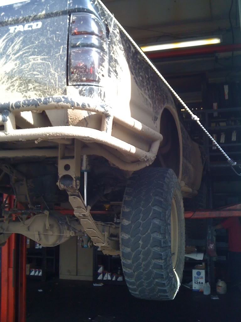

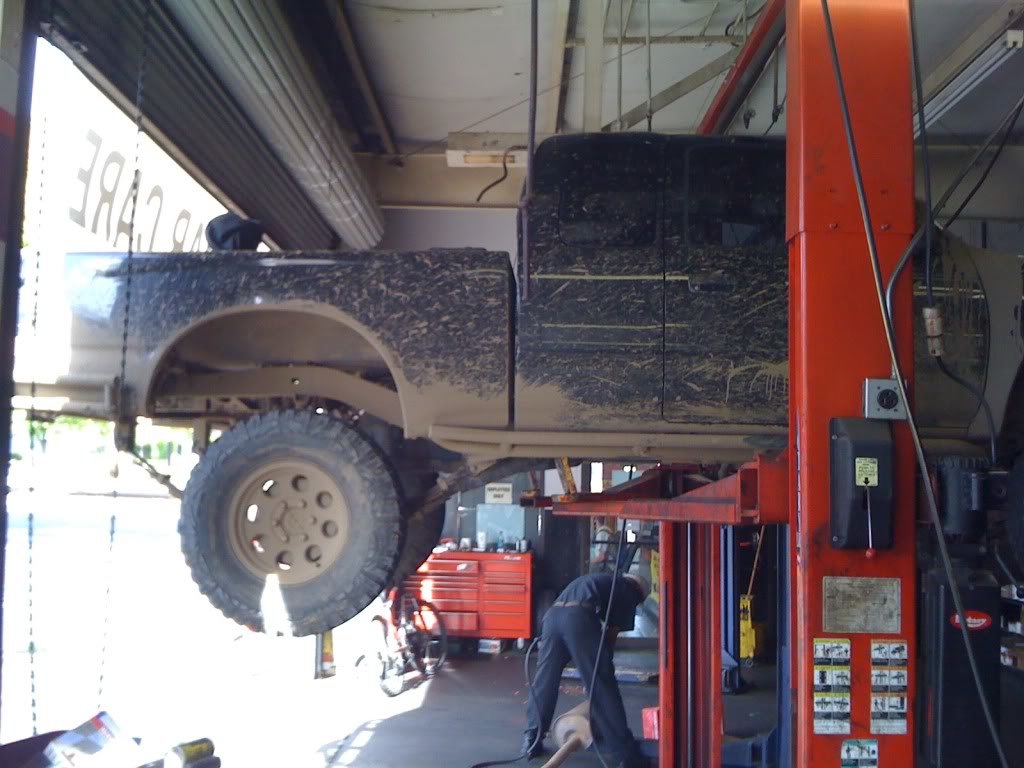

    While this is true, and I have the Giant Link Killer setup, I'd still reccomend them. I still have rear bumps. They are just plain old rubber bumps, but I have them set to hit just shy of 1/4" before full compression.
    And how bout we go back to making this a PICTURE THREAD
    Adding a couple pix of my dirty bitch:

    What's with the bungee chord holding your truck down? :confused:

    It's not attached to my truck, it's attached to the sign. Take another look at the first picture and you can kinda see their sign hanging from the bay.
