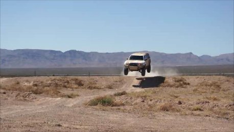

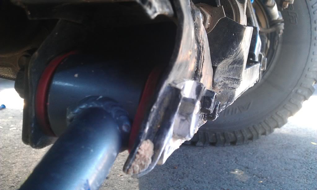

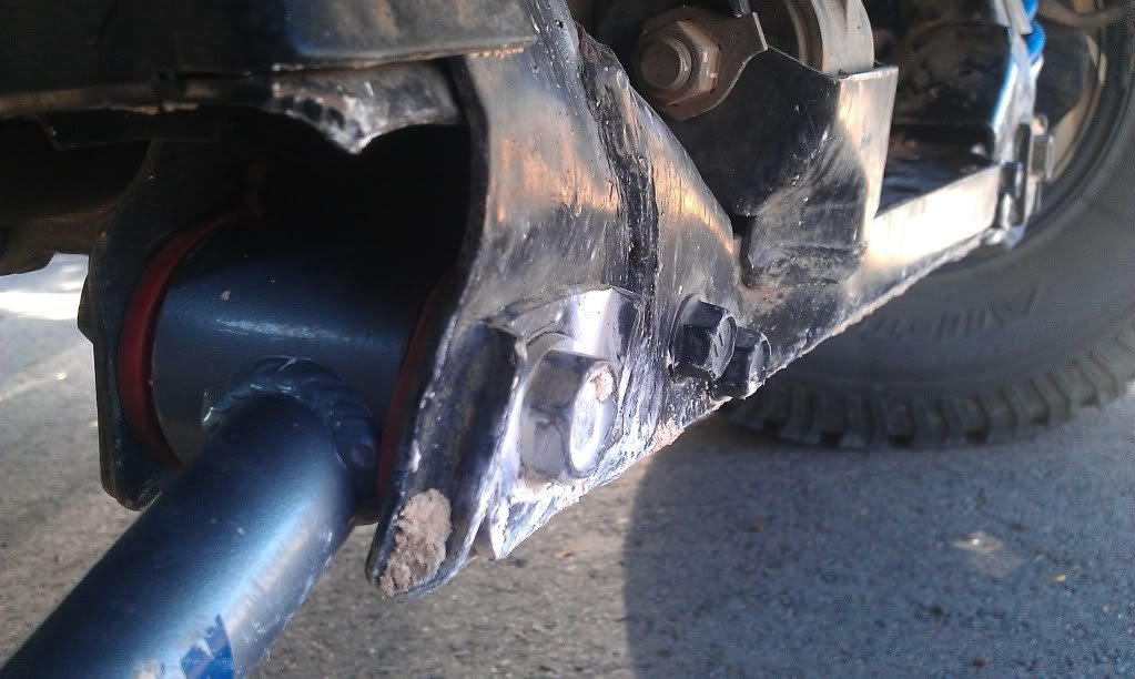

    1992 Toyo Pickup
    Me failing :eek:

    All pro LT, All pro front bumper,All pro rear fox, 1.5 full leaf and u bolt flip kit. KR sliders, bestop, high lift with custom mount, katskin leather, Hankook MT and atx artillery. DMZ SUA w/FOX triple bypass
    Man you hit it pretty hard from you pics. But for me I think the bumper did a good job and took all the hit

    to soft?

    Ha
    way to soft valving and 89-95 4x4s cross-member basically touches the ground at full bump

    Any suggestions on what I could do to make her more capable. Don't want this happening again.

    what shocks do you have, looks like kings? Are they just stock valving?

    All you need to do is throw some washers under your bumpstops to keep the tire from travelling too high up into the fender.

    Just kings with stock valving. Been reading around and looking at some air bump stops.

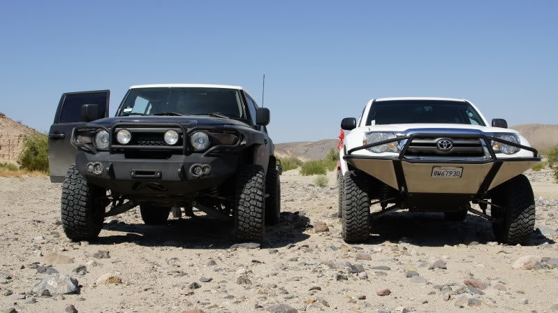

    About how much lift is that lt giving you in the front? And what size tires are on the black fj?

    It's set at about 3in in the fronts. The FJ is running 35s.

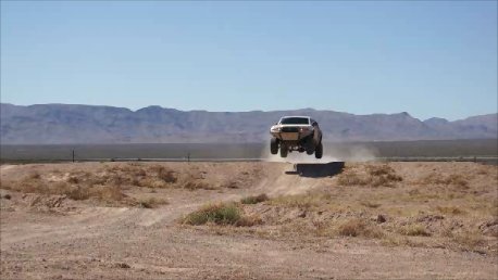

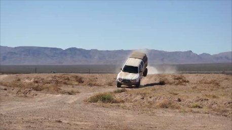

    someone doesn't sound very happy after the landing of that jump "ugh god"

    That was my wife lol.
