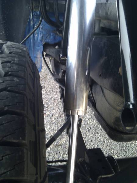

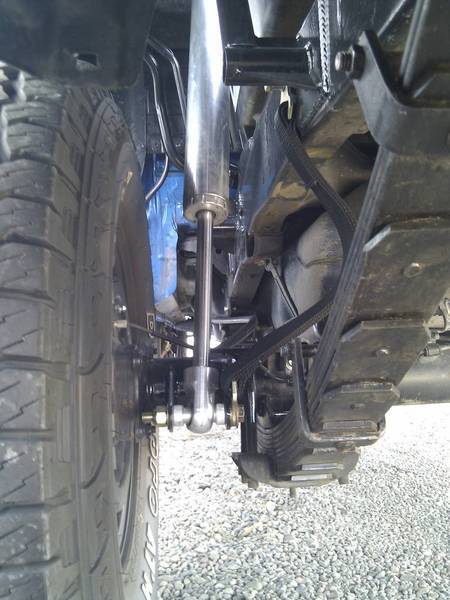

  8. Feb 29, 2012 at 12:04 PM
    #1208
    jtlachac08
    jtlachac08 Well-Known Member
    Sep 19, 2011
    #63801
    605
    Jeremy
    Phoenix, Az
    Here's some pics I just took:
    I totally understand, I've seen 1 pic and Im already in love with them lol :D
