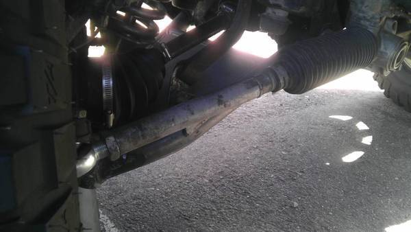

    Have the same setup as Jason. [​IMG]

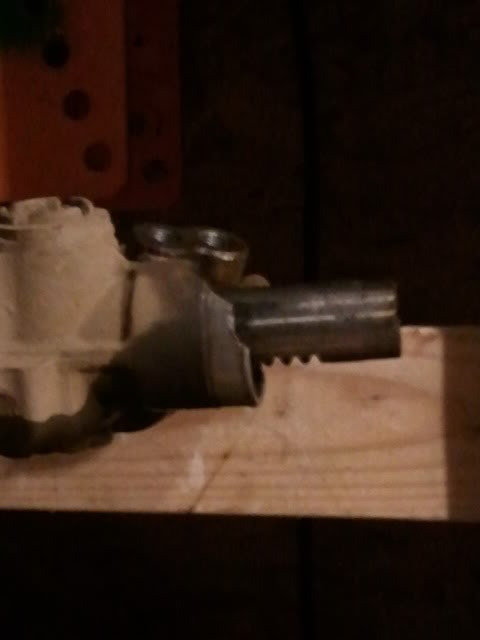

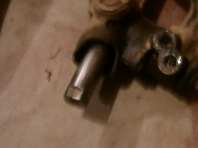

    You sir are correct! This is the result of heimed steering on my 05 and crawling with it:

    how did heimed steering affect it? i wanted to do stock length heims

    Just the abuse from impact. Think jumpin and landing with the wheels turned all the time. Stock Tie-Rods break before they beat the rack up like that.
