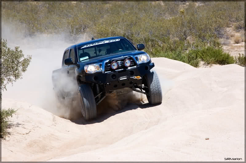

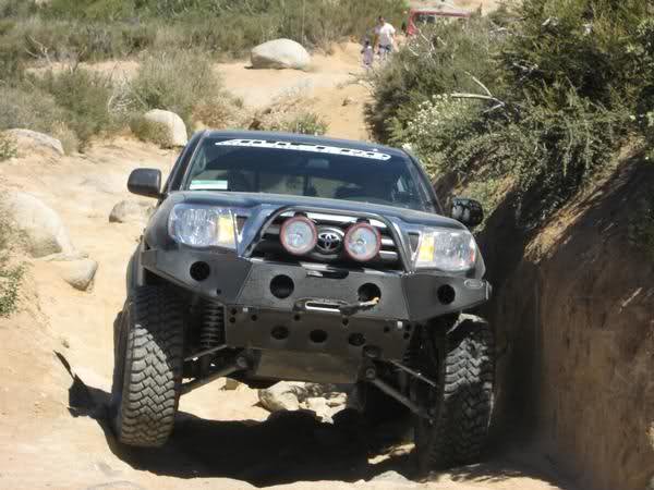

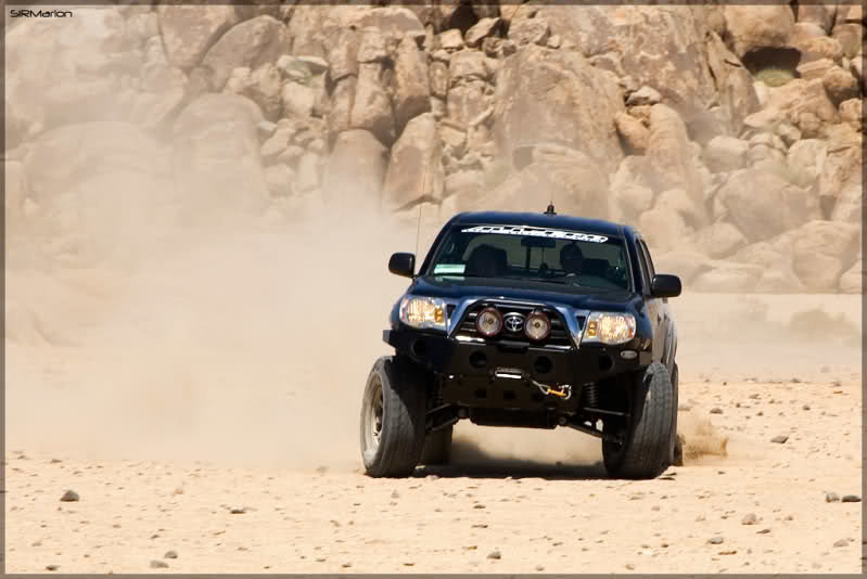

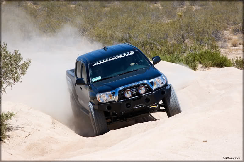

    if you do trails like i do, and if you are thinking about a LT kit...seriously take consideration into the All-Pro Long Travel Kit.. i have it and all i can say is my truck is now in a class of it's own. it's only 2" wider on each side so you wont have to have fiberglass finders, and it's not too wide for the tight trails...this kit handles great so far, the steering great...on my first run on it throught the desert i got confident enough with the kit i was pulling 4wheel drifts coming out of turns like it was nothing..total control Dukes of Hazard style haha..and, i could go as fast as i dared to while not bouncing all over the place...
    on the trail it's even better...like a mini SAC haha...the amount of up and down travel is insane and the articulation is crazy...a good example on how it did on the first trail run this past sunday...my buddy with his FJ on 35's with his front/rear locker engaged was having some trouble getting up and over some rocks..took him some work and lining up several times but he eventualy struggled over them...when i came up using his same exact line i made it up and over the first time like it was nothing..reason being, the way the front was articulating kept the wheels on the ground for traction..no 3wheeled stands like my buddies FJ..of course i had my rear locker engaged but still..
    here's some teaser pics of the kit...pics taking by http://www.SiRMarlon.comv8o211_0930a4d61f95904a7d488ae83e26a501fc358580.jpg
    these pics taking sunday at cleghorn..only 2 cuz everybody is lazy to get em uploaded haha...taking by BillDozer (TTORA)
    making the easy line hard..just testing on how stable the new track width is haha
    and...look at all that ground clearance :D
