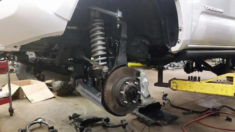

    Well I ended up doing it! Should be interesting to see how it handles. It's different, for sure.image.jpg

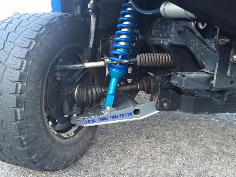

    Not " hating " but someone should point this out to you "doable " does not mean it is correct and the fact that the shop doing the work did not point this out to you is really shitty buddy...and I highly doubt that TC actually said that and here is why - your BDS Fox coilovers are made specifically for that BDS kit using the stock upper and lower control arms and stock ball joints which may pull 8" of travel ( just making up numbers to keep the explanation simple ). So, those coilovers are built to very specific collapsed and extended lengths just for that BDS 6" lift kit with stock control arms only. Even if you simply added stock length TC uppers and lowers with uniballs they would be capable of cycling 9-10" of travel but your coilovers were not built to extended or collapsed lengths to match that additional travel...then you added a +2 kit with uniball upper and lowers which will pull 11" of travel and your coilovers sure as hell will not support that additional travel. I guarantee you that your suspension is capable of cycling 2-3 more inches of travel than your coilovers will allow.
    Think about it, if you had a stock height truck with OE replacement Fox coilovers you could never add a +2 kit and use those same coilovers right ? ...becasue those coilovers are intended for stock travel #'s. A coilover for a +2 kit generally has 1" + longer body which supports the additonal 2" of wheel travel ( it's a 2:1 ratio ).
    Will your BDS Fox coilovers hold up your truck - yes, is it right - oh hell no. Your suspension is now capable of much more than your coilovers will allow. The only way to correctly have long travel with a drop bracket is to have King or Fox etc build you a custom coilover to match the exact collpased and extended travel #'s that you need. Even that blue truck above in this page does not have the right coilovers, they simply added a stupid long extended lower rod end and a stupid long rod spacer to the bottom of an OE replacement King coilover so that truck's suspension is also capable of far more wheel travel than the coilover will allow.

    That pic was sent from TC to my shop. They definitely said keeping my coilovers was fine. I'm not saying you r wrong, but I will eventually find out if they work. I can always swap out the coilovers or take the LT kit off. But thank u for the info, seriously. If anything goes wrong it's good to listen to everybody's take.
