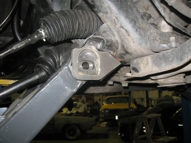

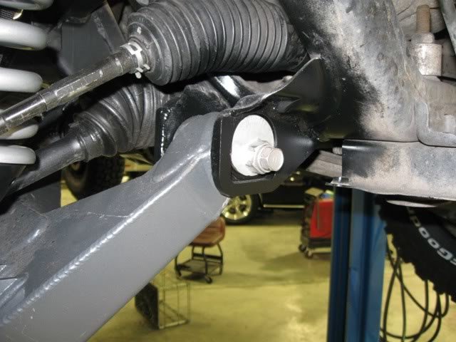

    I'm late to the party, but something that I haven't seen mentioned in this thread is mechanical leverage. The LT manufacturers have no problem installing their products with the drop bracket kit because they know their stuff is strong and the mounting location will not impact the structural integrity of their products.
    You should call BDS and get their input on the matter. If others have done this and have had issues, BDS would most likely know about it. Their kit is designed with the expectation of certain loads. LT adds stresses over stock length arms.
    All that said, I'm sure BDS over-engineered their kit just like the LT companies do with their stuff, so look up the chain for the next possible weak link.
    You may want to consider reinforcing your suspension mount points.
    This is what I did on my 2006:
    You've got the right mindset for building a stout rig. Research everything ahead of time and you'll be thrilled with the end result. :)

    BDS's and e.g. Rough Country's crossmembers/mounting points are much thicker steel than OEM mounts. So no worries. And the crossmembers are supported to each other, so there should be no kind of need to reinforce the OEM mounts.
