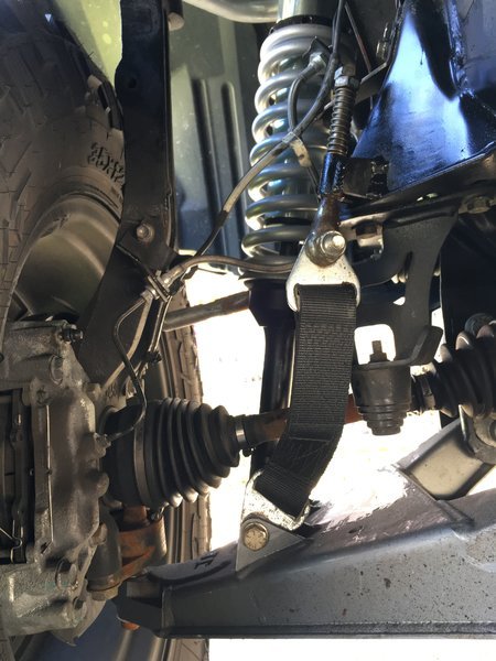

    It looks like your limiting straps are maxed out, not the shocks. Did they put different length straps on the front?
    This is kind of the down side to not working on your own truck, cause you have to pay a shop to work out the little kinks. You have to check maximum compression and drop, and make sure the shock is not over extending or compressing. It looks to me like it doesn't need that top spacer. I believe those Fox's should have around 6" of travel, so they should work, you might just have to drop the front end back down to the 6" lift at ride height.

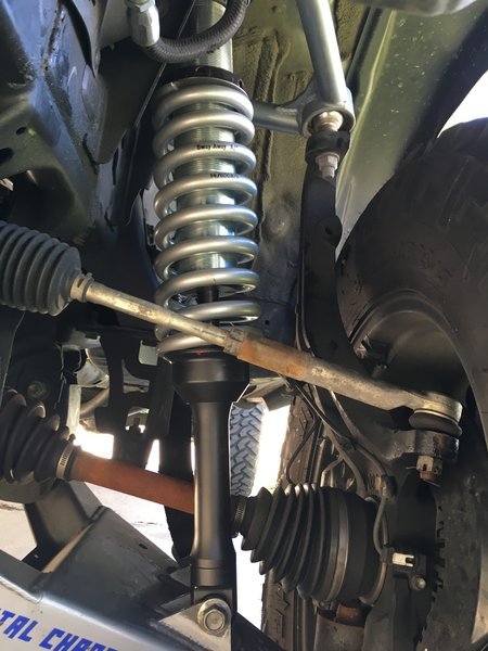

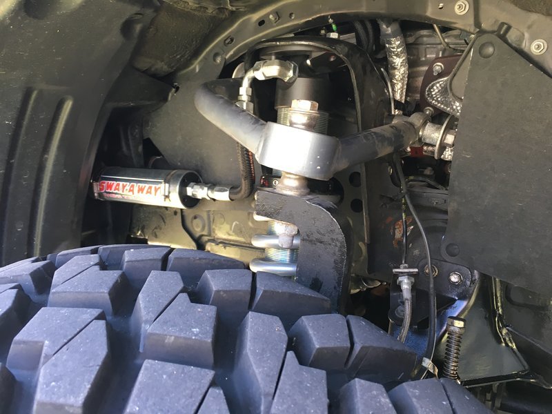

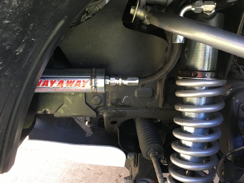

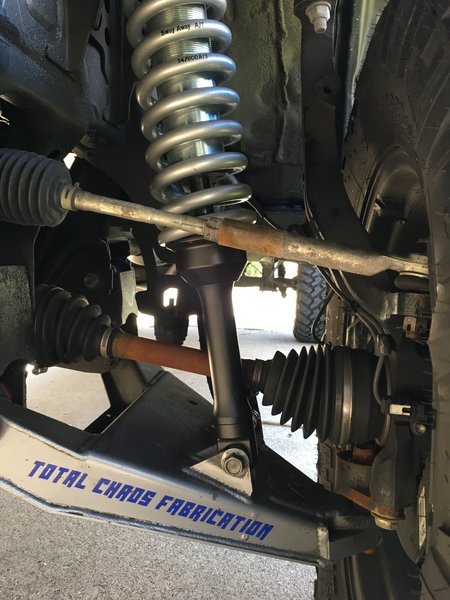

    So I had the custom Sway-A-Way coilovers installed. I've been really busy so I haven't driven the truck much since...but can tell the difference just driving around (especially highway speeds). The front end doesn't seem to lift up as much (always felt like I was catching air before). Here are some limited pics, let me know if u want a different angle or view.
