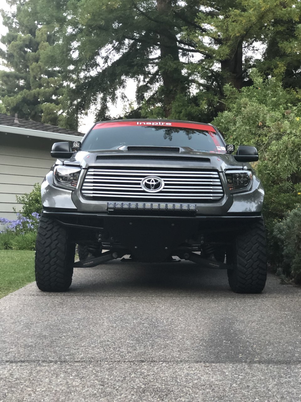

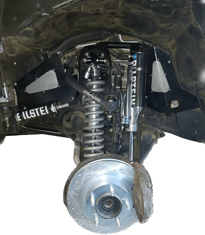

    I’d go all Camburg suspension or in Total Chaos, but Camburg I liked because it’s more stout. Bilstein 8100 series coil overs with 9200 piggybacks. Kings are alright but their shafts are soft and easily pitted from rocks or sand on dunes/the desert. Fox, ADS, and Bilstein all have hardened piston shafts, so better off-road. On these 3 ride a bit stiffer but are good on road too. FiberWerX imop is the best to go with as they have the thickest material, less damage and cracking esp if you lawn dart a jump.
    My old set up below. Hit me up if you have questions or need advice!2A75A7FF-5E26-40DB-8C9D-62A6D5086E1C.jpg
