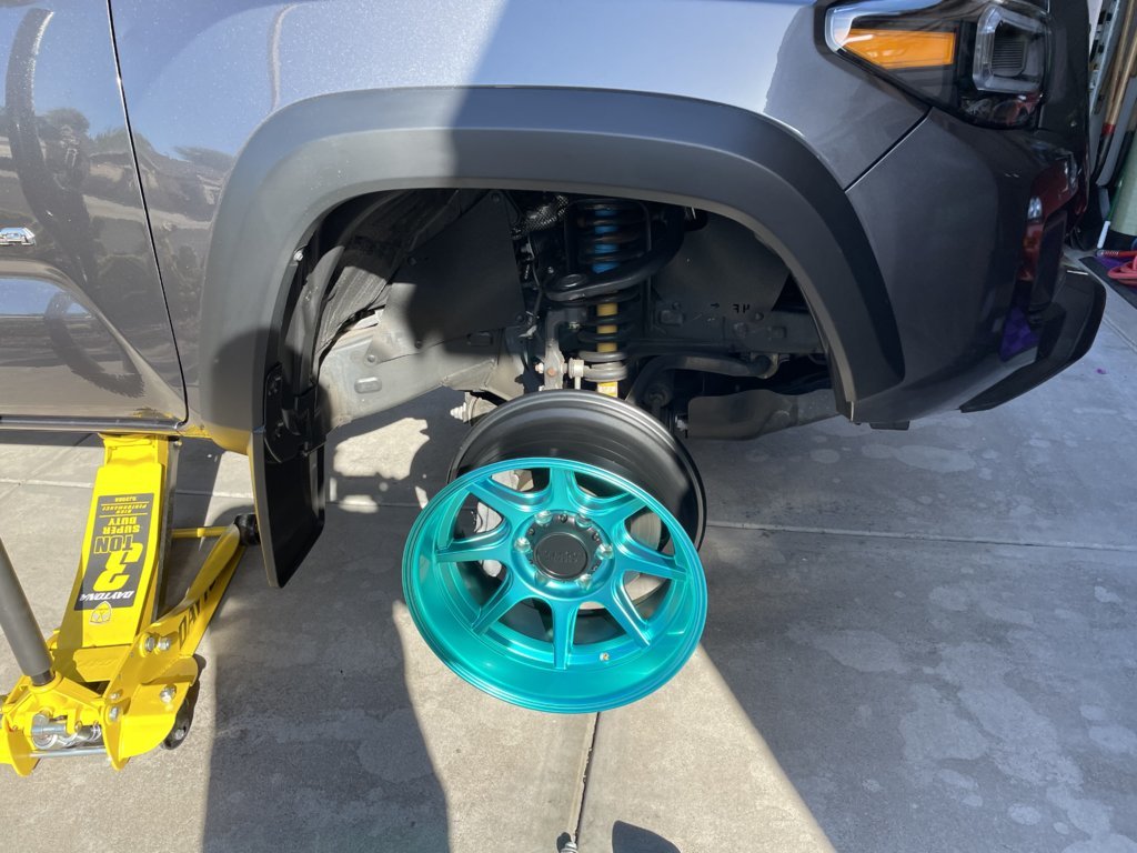

    I had to put extended studs with my RAYS. Was only getting about 5 lug turns. Ordered the ones from wheeladapter.com as they were advertised 1/2" longer.. but they were actually 1" longer.. so that made installing them in the rear 'fun'. I already had extended lug nuts so the additional length isn't a big deal, but if you run the wheeladapter.com lugs, you'll need open ended lugs as well. I don't have any wheels installed close-ups, but after swapping the studs I'm getting about 20 turns.
    My rear studs were exactly the same length as my fronts when compared side by side and the lugs installed with the exact same amount of rotations.
    A popular option are the ones from the Matrix, as they are actually 1/2" longer, which gives you 6-8 more turns which should be sufficient and safe.
    My stock studs vs the ones from wheeladapter.com:
    I had to drill holes in the rear dust shields and find hole plugs to fill the 3/4" holes required. If I did it again, I would just order the Matrix studs.
    EDIT:
    Most close-up installed pic I currently have, can see the ends of the studs about 1/2" in from the extended Muteki 45mm lug nuts. They come right to the end of the threads:
