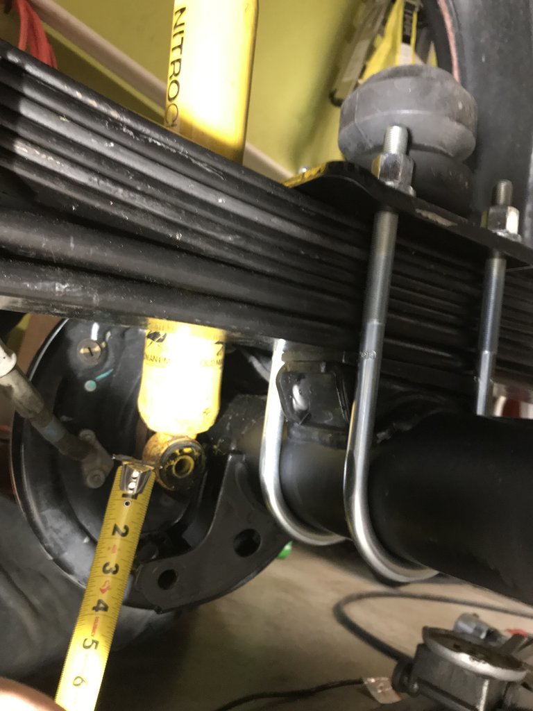

    I wonder if they will hit the back of the bottom shock mounts

    OME’s NitroCharger Sport Rear Shock Set are 14.17″ collapsed x 23.93″ extended. The Bilstein 5100 B110s measure 16.34″ X 27.28″. These are 3.35" longer so they will work. Also be aware with these longer shocks you are loosing bump travel for down travel. So make sure you cycle your rear suspension and space your bumps so you don't damage the shock on compression.

    Thanks . I have timberen bumpstops on a flip kit i can probably space them higher

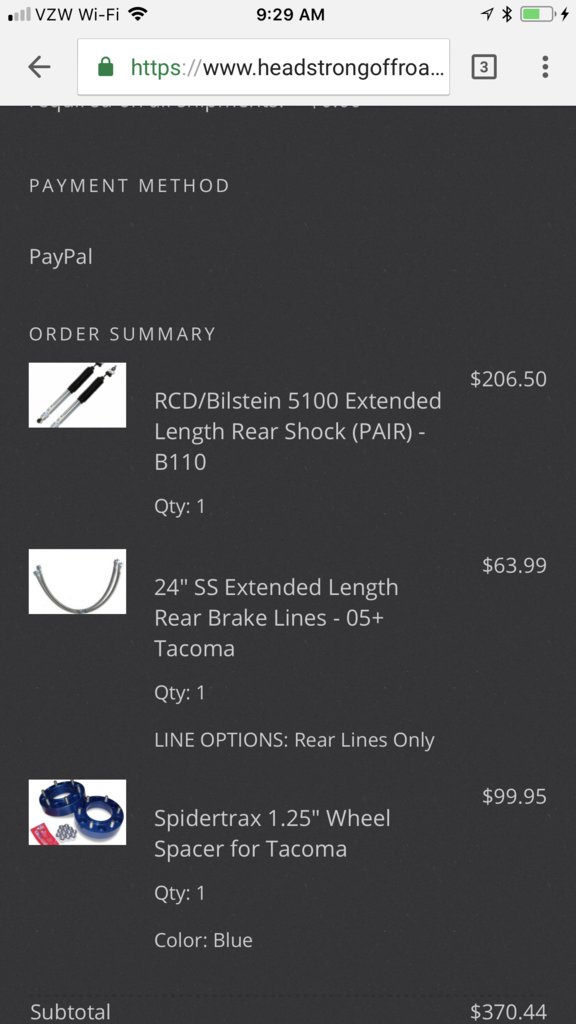

    Pulled trigger. Next on the list after New tires is Re-gear set. Nitro I think.
