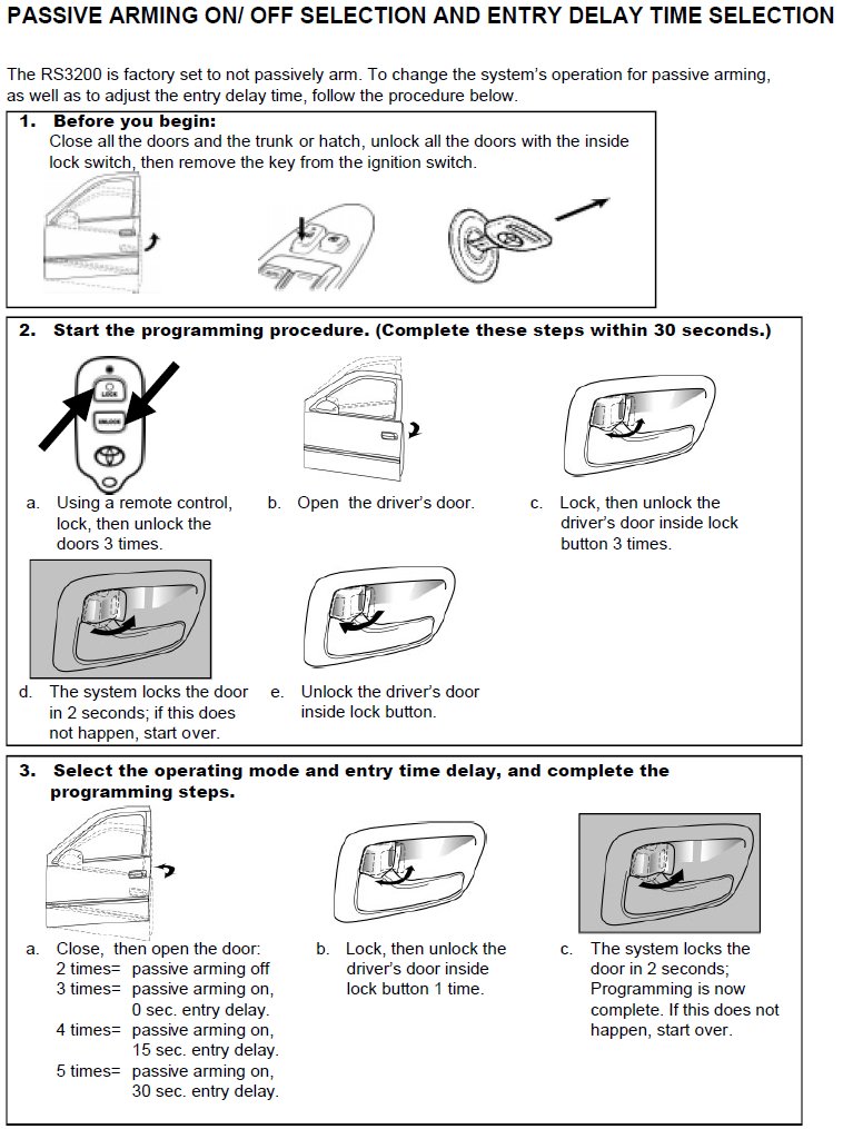

    Turn if OFF...:burp:

    Loads of Tacoma's do not have the RS3200 Alarm system and just the factory system such as my Prerunner with the 2.7 liter and No alarm system or Engine Immobilizer. It also will re-lock the doors after 30 seconds if a door is not opened.

    Well I have no crystal ball either to know if the OP has or does not have...others with bum feet might.;)

    I guess the question is,
    How do you know what system you have?

    How does 0 second delay work? Does that mean when you press the unlock it locks it right away thereby never allowing you to enter the truck, and locks you out permanently?
