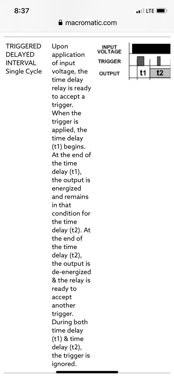

    If I were going to do this, I would use a 1 shot relay to trick the ECU into thinking that you opened the door.

    Sounds doable, maybe add a 5 or 10 second delay circuit, after the initial unlock, before it triggers the relay. It may not be necessary though.
