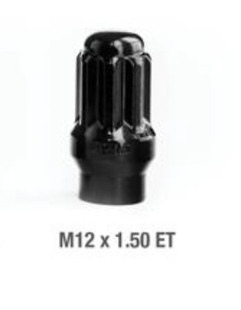

    Get some extended thread lug nuts. The thread extend into the wheels. Got these from Stealth Custom Series website...

    My studs are the perfect length so in my case the extended threads is just for extra threads. When I had spacers before I didn’t cheap out and bought BORA huncentric spacers. I didn’t have any issues with having short studs...

    The extended thread lug nuts don't fit into the lug hole in the spacer, so the option I'm going with is a longer lug. The problem is getting a size that fits without a part number. So, the extra 12 ARP studs you got for the rear axle...what was the part number?

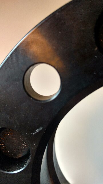

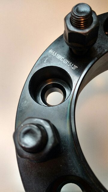

    IMG_20171229_130204145_HDR.jpg IMG_20171229_130216320_HDR.jpg [​IMG] [​IMG] A couple videos of guys installing these spacers show the same thing; a closeup of the installed spacer on a 3rd gen Taco shows that the lugs don't fill the lug nuts that hold the spacer on completely-they're too short. Took my spacers to 4WheelParts and we measured everything against the Spidertrax and every dimension was identical. They fit perfect on the hubs, the rims I have fit over them perfectly, they're snug against the hub. I just need longer lugs to be able to get more threads into the lug nuts holding the spacers on. And, I like the idea of a strong aftermarket lug so I'm really interested in finding the correct size ARP's

    You can see how thick the seats are in the spacer where the lugs that hold them on sit. There's only enough length left on the lug to thread about two thirds of the way into the lug nut. An extra half inch of length would do the trick

    Just went through the question/answer section for the reference and saw some guys said they worked. Good call! I had been going directly to the manufacturer, and of course they wouldn't commit, lol. I went ahead and ordered them. Worst thing that can happen is I have to return them and start over. Thanks for the help, fellows!

    Yes, using the black lug nuts that came with the spacers on the factory hub lugs...too short! Anyway, issue resolved. Confirmed the knurl dimensions of the ARP's will fit, the length is right, and they're 12mm 1.50. Thanks again!
