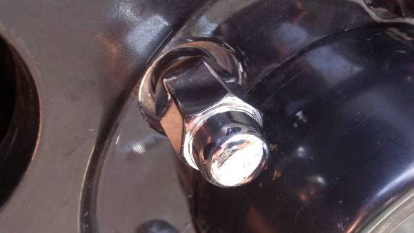

    Ive searched and searched but cant get the exact answer I need. So I'm running Wheelers 16x8's and when I first put them on, I took my 1" spacer off and realized the wheels were rubbing on the caliper so I put the 1" spacers back on the front. I looked around and decided to get the 1/4" spacers from wheelers to avoid rubbing without shaving the caliper, and got the et lugs. Go to find the et lugs dont fit in the lug holes. So I figure extended studs are the best bet. After looking around and talking to arp, the IS300 studs are probably my best bet, but they are an inch longer than stock. I dont wanna bottom out the lug before tightening the wheel down so should I just get open ended lugs? Or does anyone have any idea if I can get a stander lug all the way on(would like to get gorilla lugs)? Also is there any better options out there as far as studs? Thanks for the help

    This is as far as the ET stud will go into the lug hole

    To the OP (dad32509) what is the length of the lug in the above picture that isn't deep enough? Specifically what is the depth of the lug? I'm facing a similar situation. I want to replace my studs with something stronger and longer (better then the OEM crap). I'm wondeirng if gorilla makes a longer/deaper lug? Have you checked with them?
    Did you think about using the shorter ARP studs for the Celica (100-7718) at 2.340" long vice the longer Lexus IS 300 studs (100-7715) at 2.60" long? Would the .26" difference be enough?
