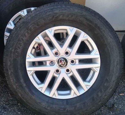

    I'm glad this post was resurrected cause I'm in the same boat, I think. I have a 2022 Tacoma SR with the crappy stock 16" wheels & tires. I was able to score a set of 2022 Tundra 18" alloy wheels, 6 lug, with Bridgestone Dueler HT 265/70R18s (see attached). I bought a set of M12x1.5 1.87" mag lug nuts & the wheel studs aren't even close to being long enough. The measured wheel thickness of the 18" alloys appears to be 9/16". Should I get the extended wheel studs from www.wheeladapter.com, the Dorman 610-463s or something else? Thanks in advance.

    I'm not too familiar with Tundra wheels and the setup Toyota implements on them. I would do a test fit of these wheels on your truck and count how many turns of the lug nut you are getting. If its less than 8, I would get slightly longer wheel studs. You will also need to know the depth of your lugnuts you will be using as you don't want to bottom out the lug nuts which would not seat the wheels correctly.

    2022 Tacoma SR
