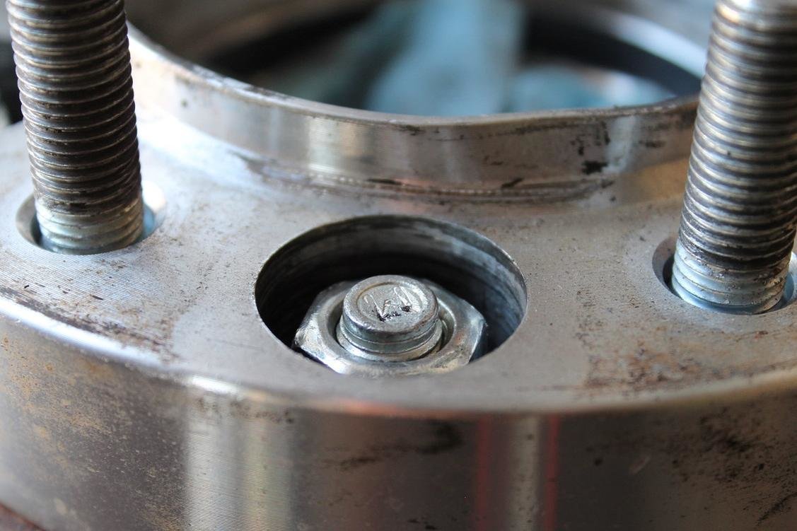

    I tried to use the Matrix studs and they wouldn't fit. Check your knurl diameter and see if this Dorman 610-376 made for a Ford will work. I've used them for well over 10k miles w some pretty good abuse mixed in there as well.

    They are 6mm shorter than the Matrix studs though. But they worked for my 1.25" wheel spacers.
