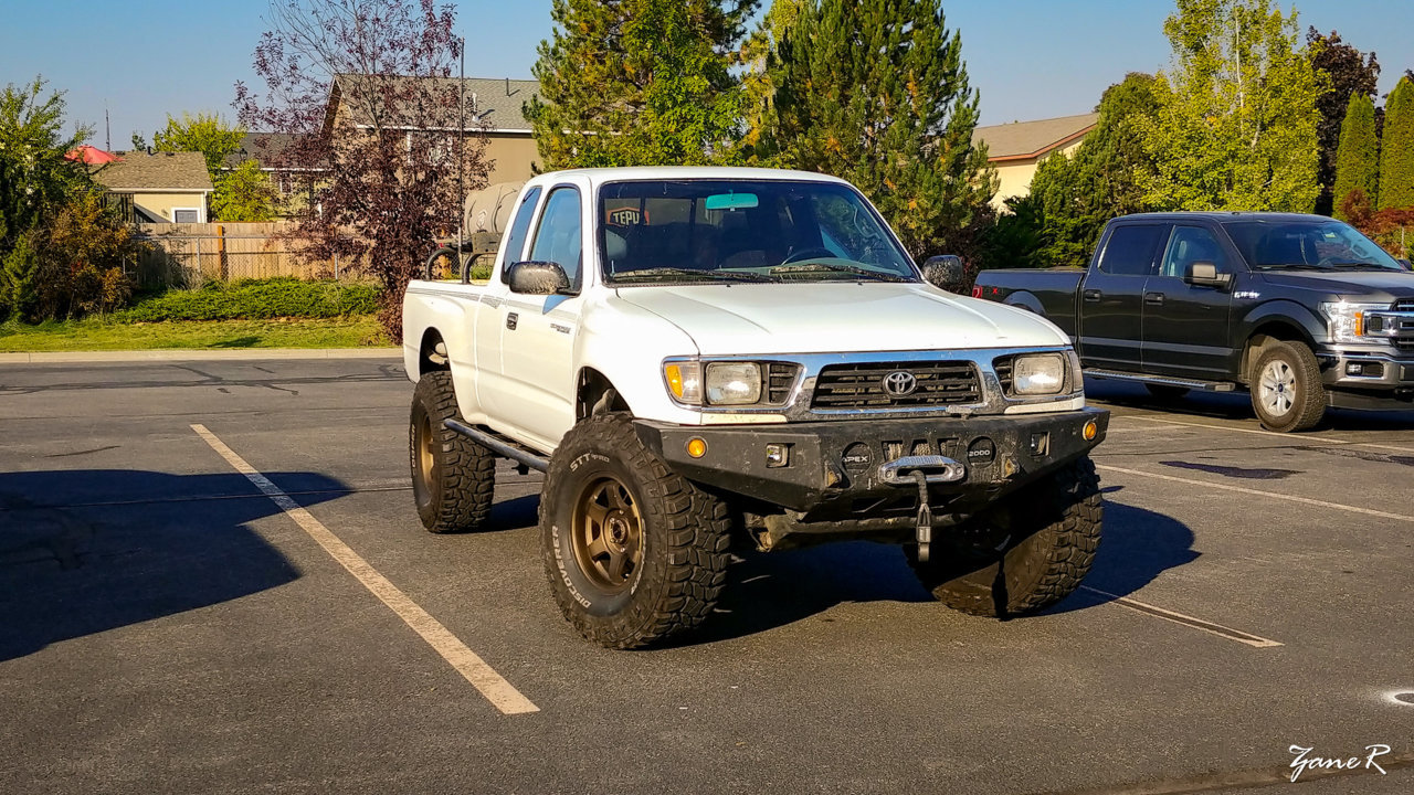

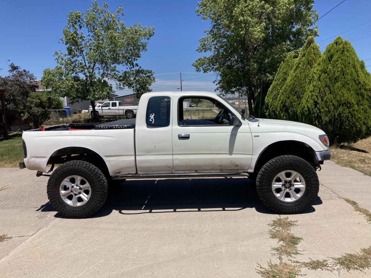

    HBS leveling kit, 31x10.50 mudders, header/imco exhaust, rear billies, LR ucas, home brewed onboard air, cb radio
    This is 35”s with about a 3” lift without LT. cut 1.5-2” out of the fender(can’t remember exactly) I wanna say I just followed the body line along the fender.

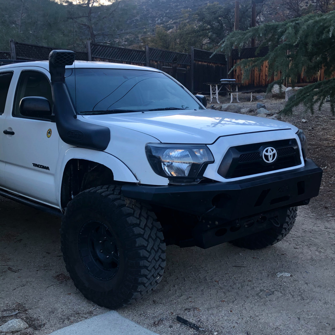

    I don’t have a 1st gen
    but just do something like this and get wheels that aren’t pushed out super far
