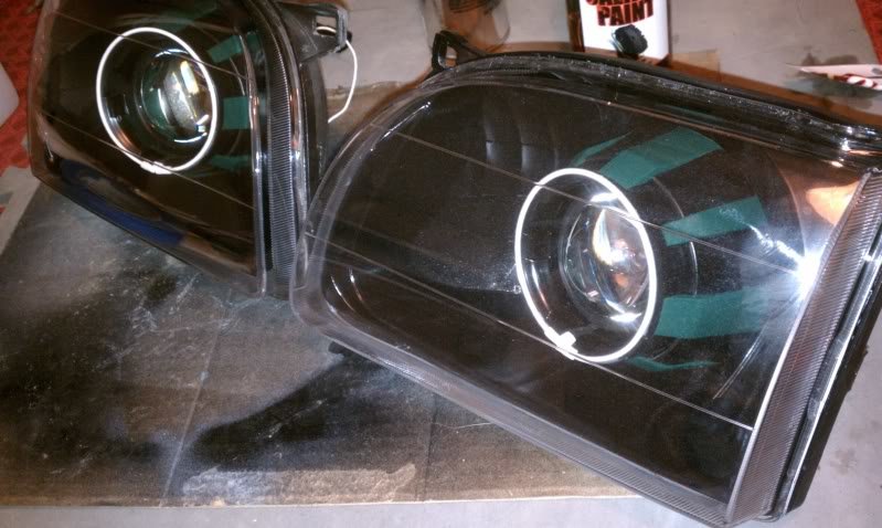

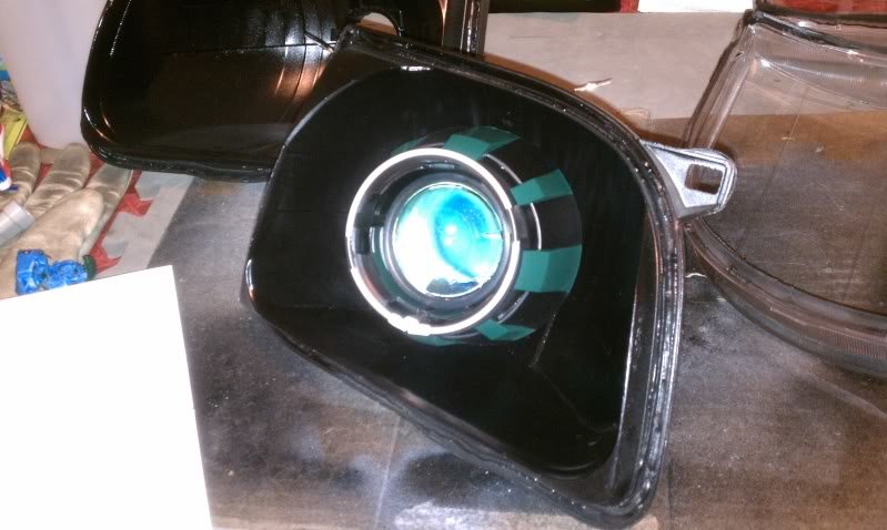

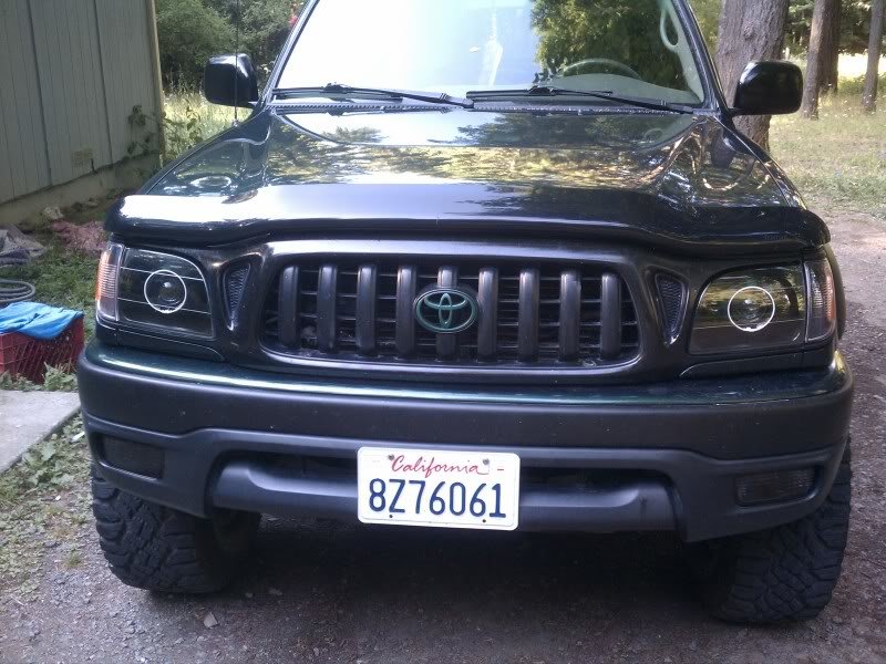

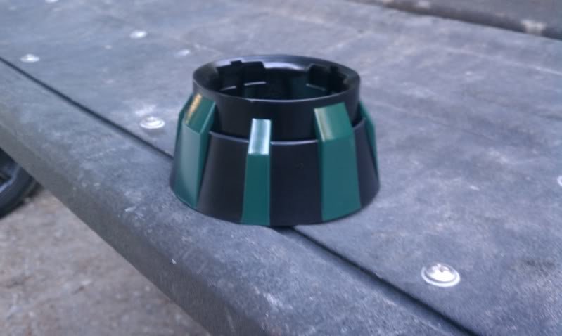

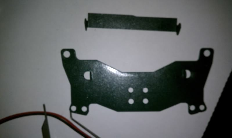

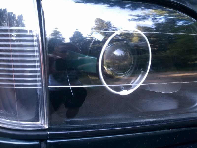

    Been done for awhile now...been busy though. Still have to wire up my ccfl's and do some aiming. Here's the final results though, what you think?
    Painted cutoff shield green...
    Finished paintin the shroud
    Green lense from the cutoff shield.
    Output shots coming soon along with the ccfl's...

    How hard/easy was it to do the retro fit? It looks really good and I like what you did with the green on the shrouds. Truck looks very nice and clean.

    Retrofit was easy...wiring was confusing because the wiring harness from theretrofitsource was labeled incorrectly. The mini d2s and mini h1's fit into the existing hole on our headlights and are held in place by a lockring in back, so no cutting or anything like that. I've never done anything like it before and it was pretty easy and straight forward. I'd recommend doing it on a extra set of headlights though just in case.

    I just so happen to have an extra set. So no drilling or cutting at all? Just put them in and try to figure out the wiring huh? Got anymore pics of it and of the beam that it puts out?

    Nope none at all. Pretty much plug and play projectors lol. Wiring will be easy for you, for some reason I had to wire the ballast output to the bulbs and the bulb output to the ballasts. Weirdly that did the trick. I can explain it in further detail if you were to run into trouble.
    Here's a write up on the mini h1's. Keep in mind the issues he had with the h1's have since been fixed by the company.

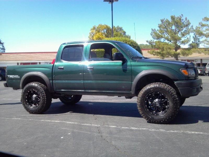

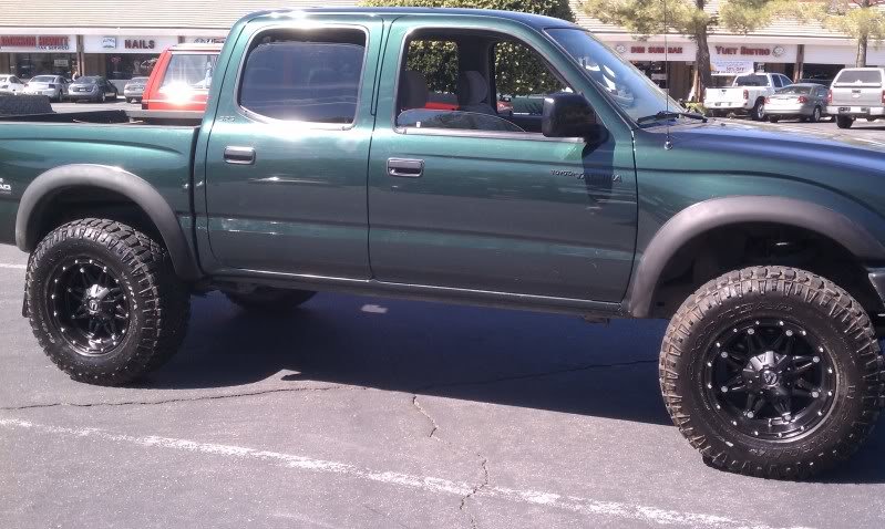

    Getting the wheels installed monday. Been in texas for the last month fighting fires, finally flying home sunday. Made lots of mod money! Heres the wheels I ordered:
    17" fuel hostage 4.5 bs
    Additionally I'm ordering a whole new lift. Going with sonoran steel coilovers up front and dakars in the rear with 5125. I'll update the build up as progress is made!

    Fuels are deff some sick wheels man, any reasons for switching lifts ??

    Having second thoughts about the lift I planned. Think ill just swap to 882's and stick with my 5100's and dakars. Either that will be next or ill start with my audio stuff.

    I love the wheel choice! Might get these as my next set
